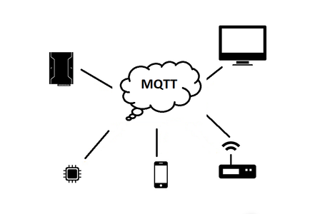

MQTT is standard messaging protocol for IOT devices. It was designed as an extremely lightweight messaging transport. It is ideal for connecting remote devices with a small footprint. This protocol is used in a wide variety of industries.
Today, we are going to create a MQTT broker using BrainyPi.
A broker is a middle man which allows the MQTT clients to communicate. The broker receives the messages from clients, filters them by topic and then forwards them to the subscribers.
