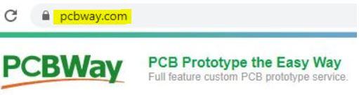

Step 6: Steps to Order PCB From PCBWay
To order the PCB first visit PCBWay.com.
Then enter the following details:
  1. PCB Size (Length & Width) and PCB quantity.
  2. Select the masking color for the PCB.
  3. Select country and shipping method.
  4. Click on the "Save to Cart" button.
  5. Click on the "Add Gerber Files" to upload the Gerber file.
  6. Click on the "Submit Order Now" to place the order for PCB.
