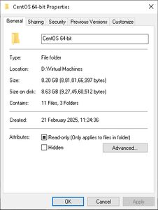

  3. CentOS Stream 10 ISO file downloaded from here. The file size is 6.85 GB. Make sure you have sufficient space on your hard disk.
Note: There must be at least 9 GB of free hard disk space for the "Server with GUI" installation (Screenshot attached). "Minimal Installation" needs 1.4 GB (Screenshot attached).

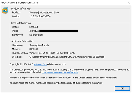

  1. Open VMware Workstation Application. Note: I have a VM workstation 12 Pro while writing this article. Start creating a new virtual machine by pressing "Ctrl + N"

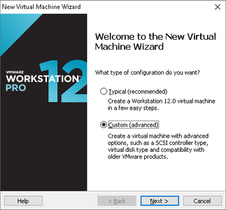

  2. Proceed by selecting "Custom (advanced)"

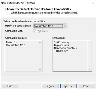

  3. Leave the "Virtual Machine hardware compatibility" to default and continue.

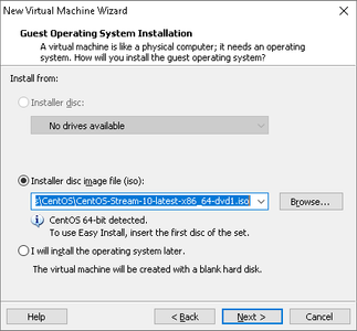

  4. Using the "Browse" button select the installer disk (ISO file)

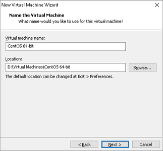

  5. Name the virtual machine and set the location of the VM

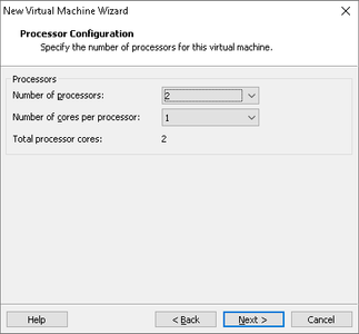

  6. Configure the processor to match your needs. I have selected 2 processors.

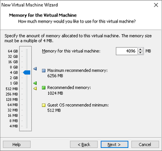

  7. Configure Memory for the Virtual Machine. I configured it to have 4 B RAM.

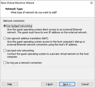

  8. This VM has to participate in the network, select "Use bridged networking" and proceed.

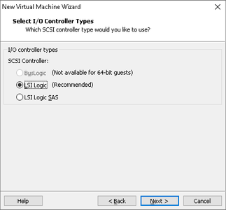

  9. Leave "I/O controller types" to default and continue.

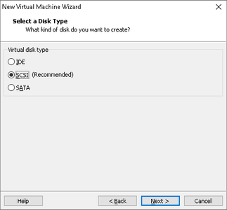

  10. Leave the "Virtual disk type" to default and continue.

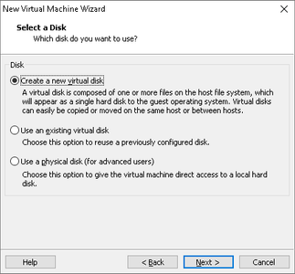

  11. It is now time to configure "Disk". Proceed by selecting "Create a new virtual disk".

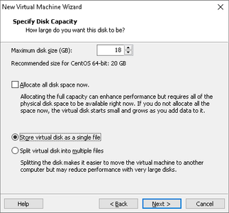

  12. "Specify Disk Capacity" to your individual needs. I specified the "Maximum disk size" as 18 GB, and selected "Store virtual disk as a single file"

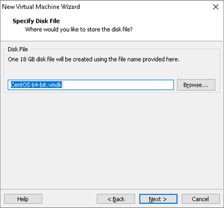

  13. Specify the "Disk File". You will have an option to change the name. I left it to default.

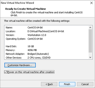

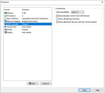

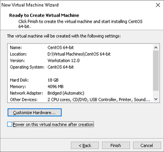

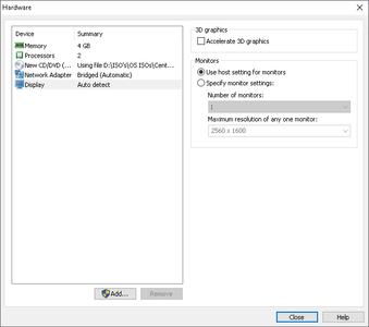

  14. Please select "Customize Hardware" from the "Ready to Create Virtual Machine" screen and remove what you feel is not necessary for the virtual machine. I removed the "USB Controller, Sound Card, and Printer".
  15. Click on "Finis" to complete this step.

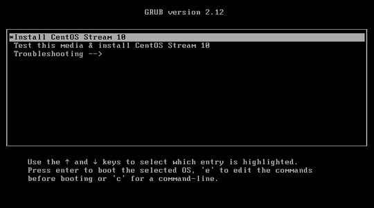

  1. On the first screen, you will be prompted with three options:
  2. Install CentOS Stream 10 - I selected this option as I used an ISO file and there is nothing to test an ISO file.
  3. Test this media and install CentOS Stream 10. This option is necessary when we use physical CD/DVD media.
  4. Troubleshooting

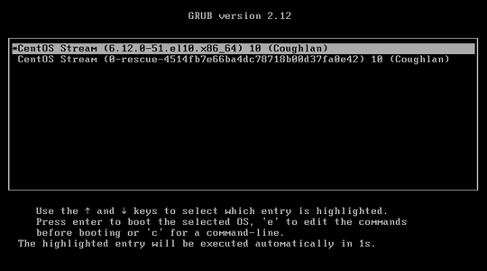

Step 5: Expected Error With Minimal Install and Its Resolution
As shown in the screenshots, on machine reboot, there is a continuous display of a message: "IPV6: MLD clamping QRV from 1 to 2!".
  1. Ignoring the message appearance, login to the machine by entering "root" user credentials.
  2. Execute: "sysctl net.ipv6.mld_qrv=1"
This will stop the message from reappearing, and help us work with the machine.
The message will reappear every time the OS boots. A screenshot with boot options is provided in this article.
To permanently suppress it, edit the file "/etc/sysctl.d/98-mld_grv.conf" and enter "net.ipv6.mld_qrv=1" in the file. Save and exit. Reboot the machine by executing "init 6" and check.
