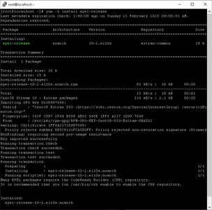

  3. Execute "yum install epel-release -y" (Screenshot 13)
  4. Execute "yum install wget -y"
  5. Execute "yum update -y". Please note this step may take some time to complete. Please allow the machine sufficient time. Around 80 packages get updated and installed.
  6. The last screenshot shows you the successful completion of "yum update -y"

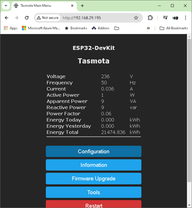

Step 6: Connecting & Testing Smart Energy Monitoring IIoT Device
To connect and test the smart energy monitoring device, I have accessed the web page of my microcontroller with tasmota installed on it.
Readers are requested to go through the screenshots to understand the process step-by-step

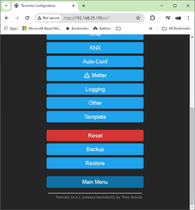

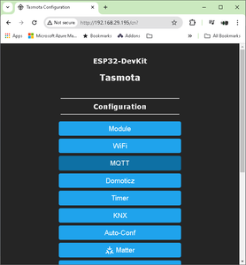

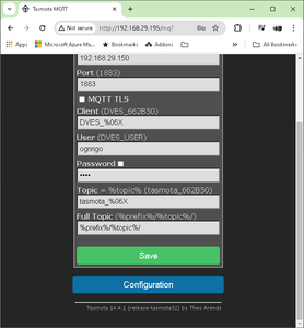

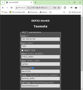

  1. Access the IP address from Internet Explorer (192.168.29.195 is the IP address assigned to the microcontroller in my case). Select "Configuration"
  2. Select "MQTT"
  3. Fill details: Host: 192.168.29.150; Port: 1883; User: ognngo; and Password: abcd1234. Hit on "Save" and move to "Configuration"

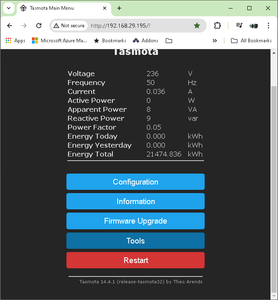

  4. Select "Main Menu"

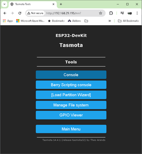

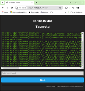

  5. Select "Tools"
  6. Select "Console" to see the data getting posted to our mosquitto broker.
  7. Navigate to "MQTT Explorer" to see the data getting captured and represented graphically.
