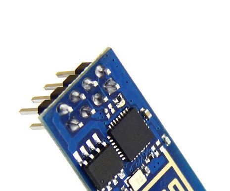

In this in instructable ,I will show you how to use MQTT protocol with ESP8266 and node-red platform.
HTTP being used on request-response is not the best option for transferring data fast and efficiently .On the other hand we have MQTT which is lightweight , fast and best for sending data over different IOT devices.
We have only two things in MQTT
  1. Client
  2. MQTT broker
Client can be publisher or subscriber.Publisher ,as its name suggests ,publishes data and Subscriber receives data.
It is broker which makes the link and pass the published data from publisher to subscriber.
To resolve any conflict in data transmission there is topic in MQTT.
Each client(Subscriber) that wants to receive messages subscribes to a certain topic and the broker delivers all messages(from publisher) with the matching topic to the client.
