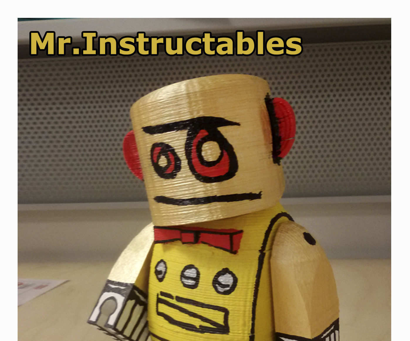

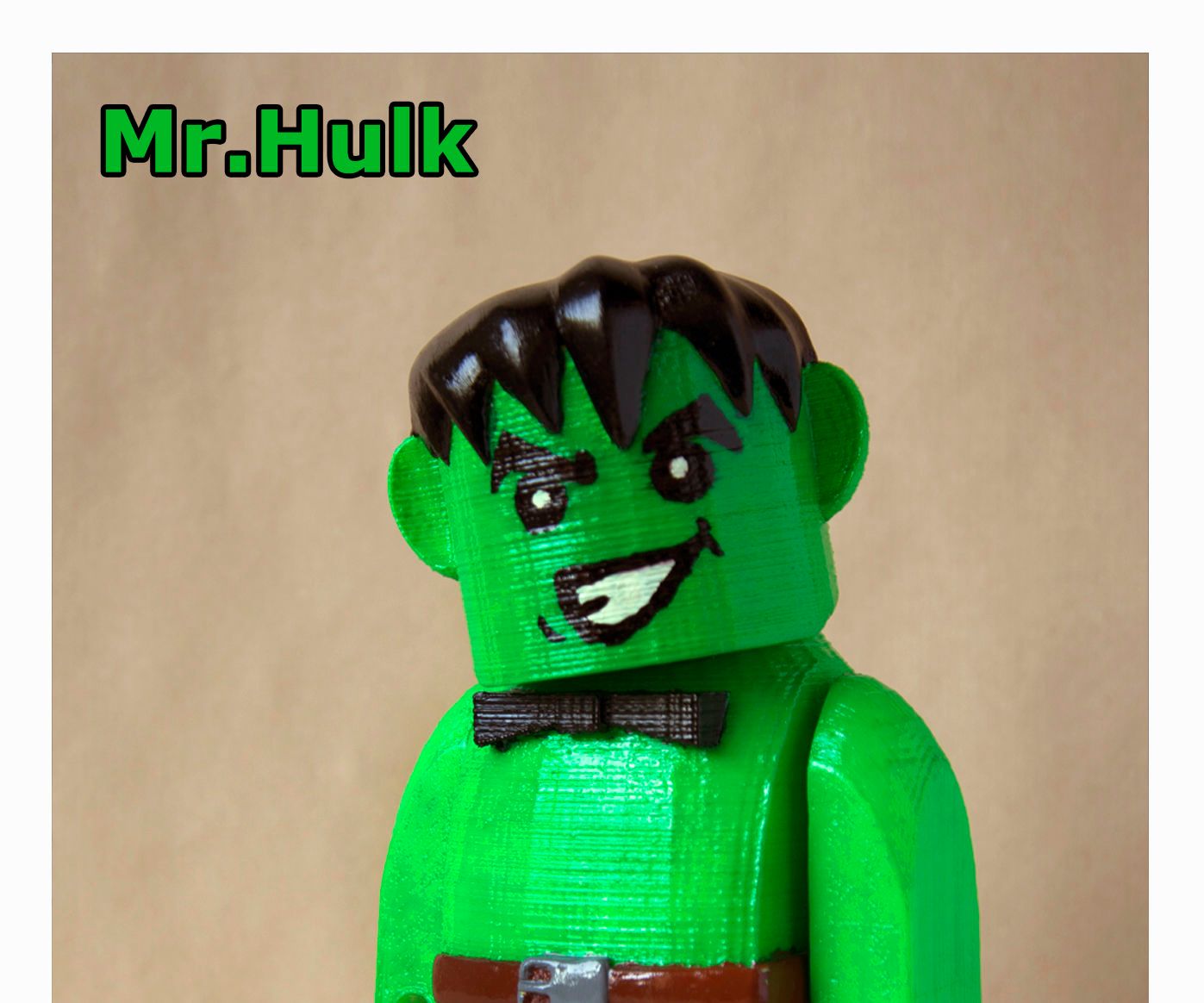

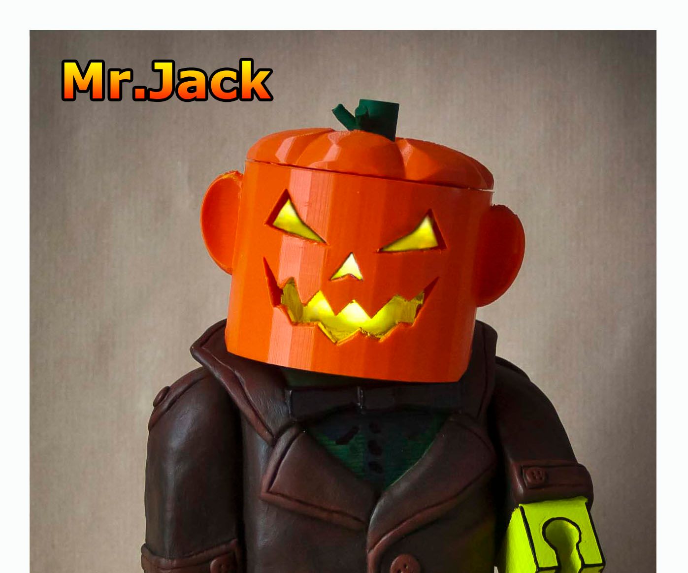

To decide how to customize MR:NONE, you can download the TEMPLATE and start doing some sketches. This will help you doing preliminary tests! You can look at the example in the pictures!
You may customize the toy in two different ways:
- You can import the components of the toy (STL) in a 3D modeling program (Tinkercad, 123D Design, etc ...) and edit them turning them to your liking.
You can look at the example in the pictures! - You can Modeling with traditional sculpture techniques, applying the milliput on 3D printed plastic components. So you can edit them turning them to your liking.
Finally you can customize your MR: NONE painting it with acrylic paints or coloring with markers!
