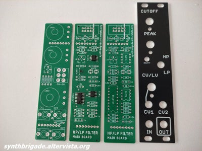

The module is made of three PCBs: a front panel, a front board and a main board.
Main board comes in two flavours: full through-hole (THT) components and mixed THT and surface mount (SMD) components
I generally prefer to use THT components because they are easier to solder, and I especially like the possibility to swap them with other equivalents to ear the differences. In this very special case, the OTA (LM13700) is now difficult-to-impossibile to find in DIP format. There are (most often working) clones one can buy, but if you want a legit chip you are forced to use LM13700 in SMD format (SOIC).
This is why I designed a main board with some SMD components: the OTA, the two op-amps and the transistor pair.
In the following the Bill Of Materials for main boards and front board. The front panel has no components.
Where components are different from SMD and THT versions, they are reported in parenthesys.

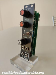

The module is designed for compatibility with standard Eurorack synthesizer formats, ensuring ease of assembly and integration.
I spent due efforts to keep the module width as small as possible, ending at 6 HP.
The module features two CV inputs, one direct and the other with control over CV level. CV level is a simple potentiometer in voltage divider configuration, so nothing fancy.
This design operates either as low-pass or high-pass filter. Changing operation mode is as simple as flipping a switch from one position to another.
This configuration flexibility allows for diverse sound-shaping possibilities within a modular synthesizer setup. You can use a single filter and have a two poles filtering, or increase the number of filters in series thus increasing the number of poles. If you want to reproduce the MS20 filter configuration, place two of these in series, the first one in HP configuration, the second one in LP config and there you are :) .

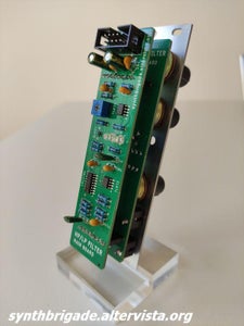

The module is made of three boards intended to be stacked one over the other. The first one is the front panel. This has no traces and is intended for mechanical installation on your eurorack case. It is preferred to be realized in alluminum alloy.
The other two PCBs are the front board and the main board. Front board hosts jacks, mode switch and control potentiometers. The main board hosts most of the filter circuitry.
The module is intended to work on +/-12V, but should work on +/-15V without problems.
As already said, I have layed down not one but two versions of the main board for this filter. The first one is made of THT components only. It's easyer to build, but you could have some trouble finding legit components for it. In the moment I am writing, four-out-of-four main sellers don't have the LM13700 in DIP16 package in stock (as far as I know Texas Instruments has discontinued the production of the DIP version some year ago, while the SOIC is still in production).
This is why I also layed down a version with some SMDs. This version could be more complex to assemble by yourself, but at least you can find legit SOIC16 LM13700!

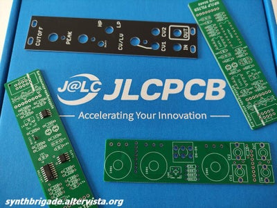

If you don't feel confident soldering small SMD components, be aware that most PCBs manufacturing Companies offer SMD assembly service you can take advantage from.
Main board PCB you see in this Instructable pictures has been partially populated by JLCPCB SMD assembly service. Very good results indeed!
They have legit LM13700 in stock, so it's a good way to catch two birds with a single net ;)
Please notice that only SMD components will be assembled; THT components will need to be soldered.
