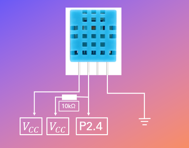

Step 2: Connections
The connections should be done as seen above in order to work with our code. (P2.4 is used)

DHT11 uses a single bus connection meaning that we can only use one connection for both sending and receiving data to the sensor. This provides a small obstacle since we have to set the direction of the port (of MSP430) first as an output and then as an input.
Once properly initiated with the sequence that is mentioned in the slide, DHT11 starts to send the data (1+40) frames which correspond to Ready to Send (1 bit) + (1 byte humidity int.) + (1 byte humidity frac.) + (1 byte temperature int.) + (1 byte temperature frac.) + (1 byte checksum) = 41 bits (total)
