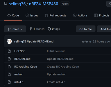

For the TX and RX code you'll use my repository for the project:
https://github.com/selimg76/nRF24-MSP430 (1st pic)
In the Repository, the code related with the TX is:
main.c and nrf24.h

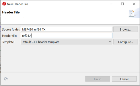

Once you create a new project in CCS, just copy the content of the main.c from the repository and paste it in the main.c which is automatically created by the CCS. (2nd pic)
Then by right clicking on the project in the project explorer and selecting New > Header File, create a header file and name it nrf24.h (3rd pic, 4th pic)
As you save your project after these updates and connect your MSP430 to your PC, you can click on the 'debug' button and after the debugging is finished, you'll have your TX up and running. And the Transmitter will be sending the "payload" integer array to the receiver.
