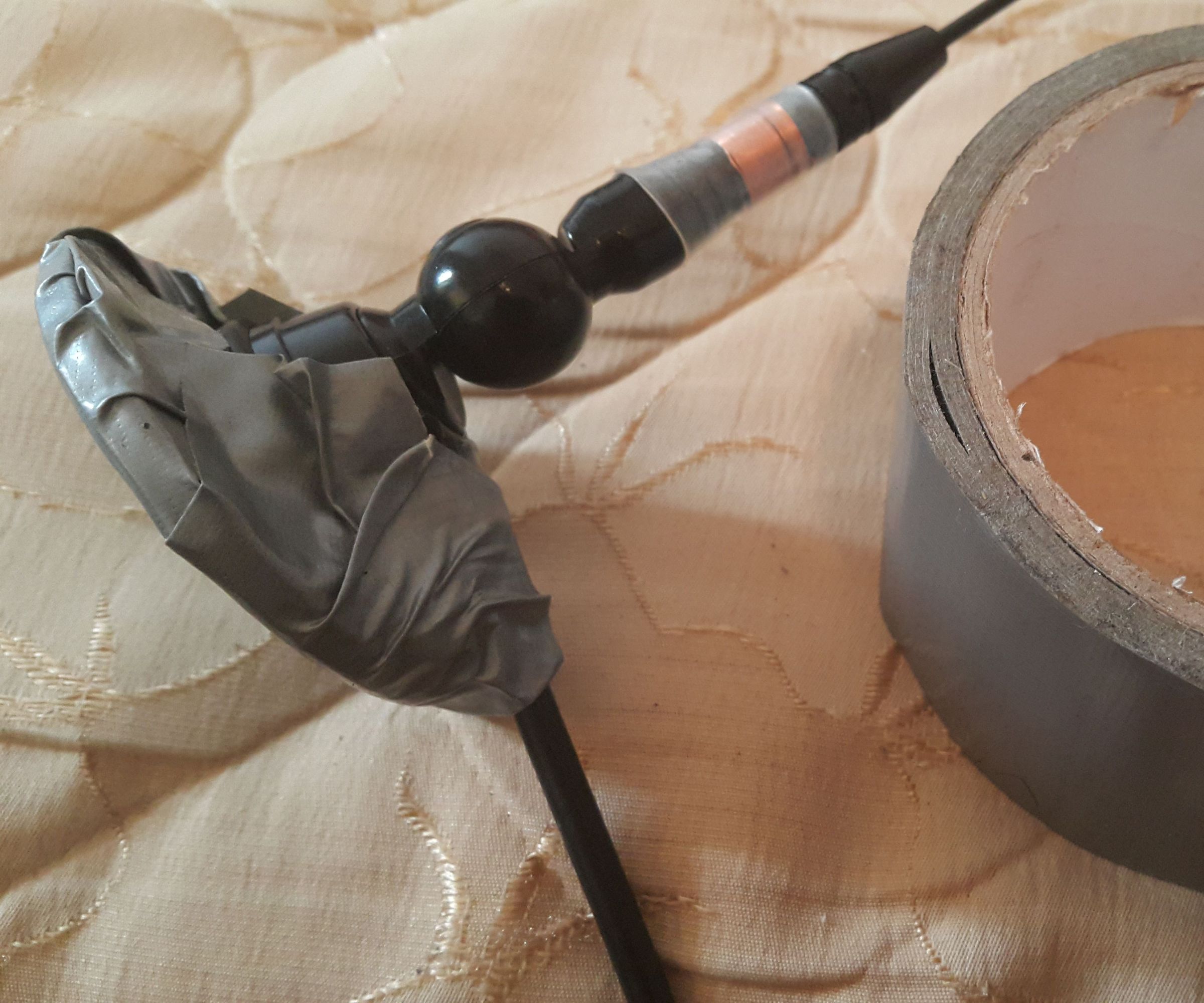

Apply thermal compound to the radiator and bolt the TIP 121 onto it with a connection of choice. Extend the E,B and C, TIP 121 pins with thicker cables and connect it to the scheme. The LM35 (DZ - for degrees Celsius if you are from Europe like me ;) ) can be supplied with variety levels of voltages from 4 to 20V DC. It seems to be nice to use 8 volts here ( (20-4) / 2 ), though it is not standard and I went for 12, supplied from the external source ( The car battery ).
Solder a bridge cable between the two negatives of the MCU's power supply DC/DC converter to balance the ground currents so your MCU can read the temperature correctly. Add an external LED with a 470 ohm resistor to monitor the error of the P-controller. If it glows, its negative, if it's shut off its positive and the fan blows.
Now take the audio cable solder the red wire to the LM35 power pin, shield to the ground pin, and middle pin ( signal output ) to the black wire, that goes directly to the MCU's analog. Done
