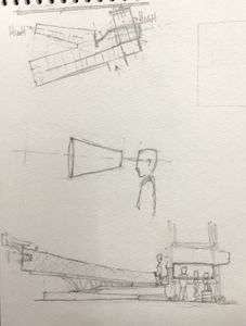

Go to your site! Observe, photograph, interview, hang out!
Step 2: Draw

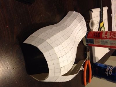

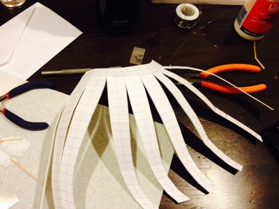

Step 4: Design

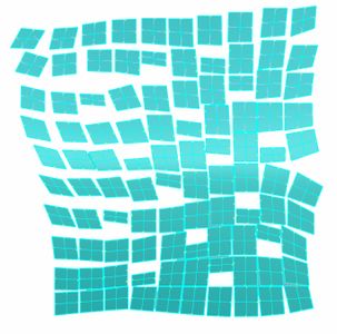

Rhino - create the form using the paneling tool and unroll the form to make the individual panels
CAD - lay out the panles onto sheets to be converted into cut files
V-Carve - import the CAD files to make cut files to be CNC routed

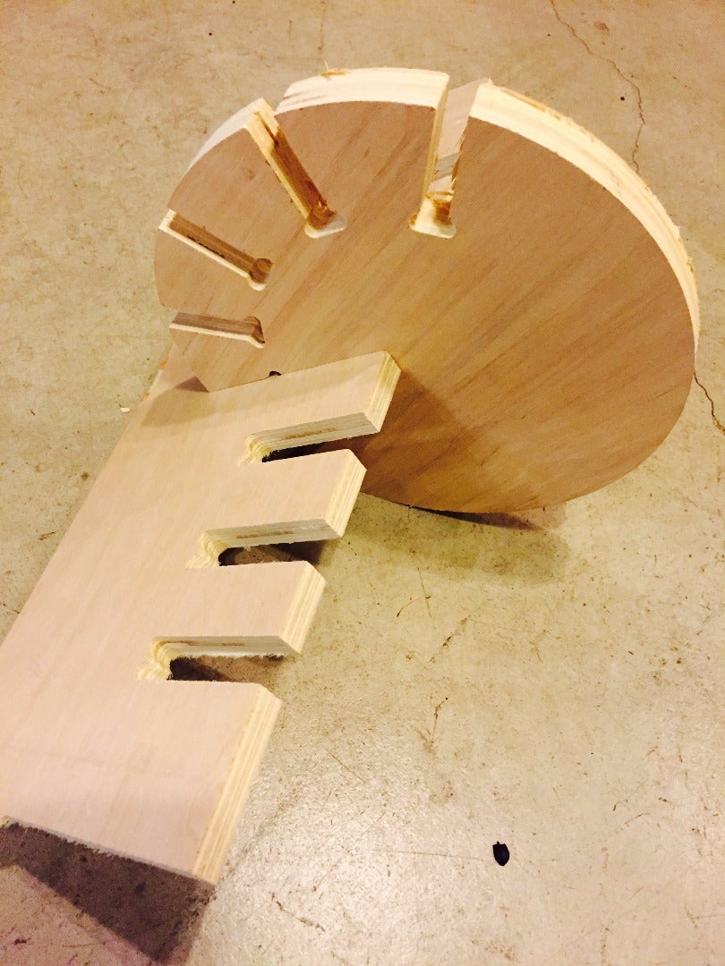

Step 5: Budget and Materials
Mockups and testing of materials
$500
Main structure panels (Local lumber yard)
4'x8'x1/2" 5 ply birch plywood ($40 each x 50 panels)
$2000
Joints (Local lumber yard)
4'x'8'x3/4" 7 ply birch plywood (10 panels)
$500
Mirrored Panels (Tap Plastics)
4'x8'x1/8" mirrored acrylic panels(30 sheets)
$3000
Floor (local lumber yard)
OSB panels
$100
Framing and fasteners
$200

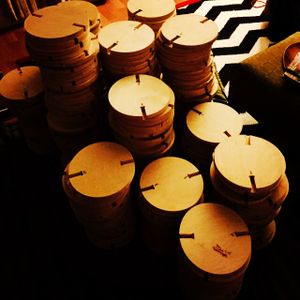

Step 7: Fabricate
