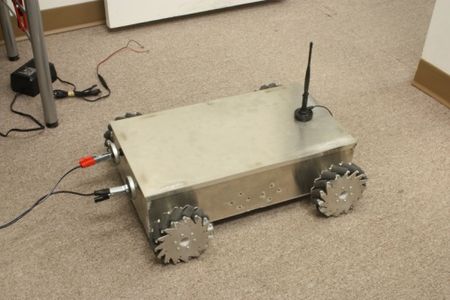

For this project we want to use a PhidgetsSBC as a functional brain for a mobile collection of Phidgets sensors and controllers in the form of a wheeled robot. To make things simple we should have independent control of each wheel, this means we do not need any differentials or complex mechanics to split power between wheels. To make manoeuvring a bit easier we also chose to use mecanum wheels. These wheels will allows the robot to move in any direction without actually turning. On the robot we would like to mount a WiFi antenna so that we can transmit information back and forth between the SBC and a PC wirelessly. In addition we want a webcam on board so that we can see what the robot sees and will make remote control easier.
Time: Assuming you are fabricating your own chassis something on the order of a week to a week and a half, not including time for parts to ship.
Skill: Medium difficulty. You'll need to be proficient in fabricating and welding, and some knowledge of linux and programming in C will help you to make this project your own.

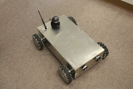

  • 1 Webcam with pan/tilt functionality

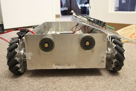

Step 2: Design and Assembly: ​Chassis, Motors, and Power

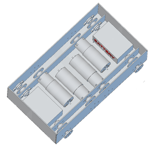

We designed the robot in a relatively inexpensive 3D CAD tool called Alibre. You can download our design files for Alibre here. We designed the robot to be made from 1/8" aluminum - although there is no reason it couldn't be made from steel. By designing in small interlocking tabs where the sheets of aluminum come together, it's much easier to correctly assemble the robot before welding. The pictures show our design for chassis and drive train.

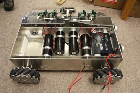

The motors mount to the interior walls. Notice the holes machined into the side of the chassis? they are there to allow easy screwdriver access to the motor mounts.
The frame was welded together using a TIG welder. If you don't have a TIG or MIG welder, and you want to avoid aluminum, you can use a blowtorch with a special type of brazing rod.

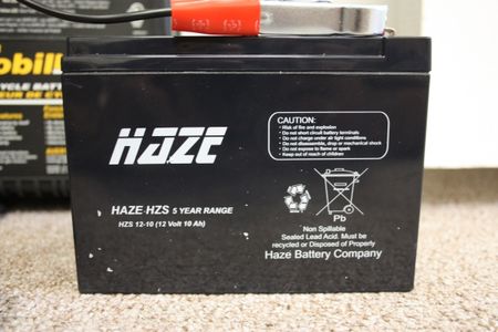

We used a pair of 12V, 10Ah lead acid batteries in series to generate 24VDC. We fused the output of the batteries with a 20A fuse. 20 Amps was necessary, even though each of the four motors is rated for 2.2 Amps continuous. DC Motors will easily consume much more than their rated current under heavy load or start up. We would occasionally blow the 10 Amp fuse. 15 Amps would probably be sufficient.

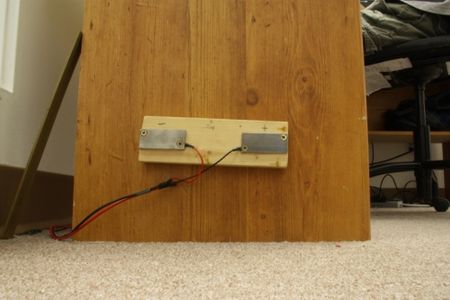

To recharge the batteries we mounted a pair of contacts on the front of the robot so that we wouldn't have to open the lid to recharge. These contacts are actually magnetic welding ground clamps - power is transmitted through the centre copper slug, and the spring loaded magnet around the slug applies a constant pressure. We have two steel contacts on the wall connected to the battery charger. We can also clamp the battery charger directly to the copper slugs if someone is using the robot in a different office.

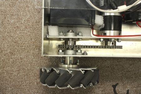

Step 4: Design and Assembly: ​Sprockets and Chains
Timing belts are quieter than chains, but you have to order exactly the right size. Chains are able to transmit a massive amount of torque, and the length can be (relatively) quickly changed.
When you are trying to decide how much chain you will need there is a simple formula you can use. For our robot we used sprockets that were all the same size, this leads to a gear ratio of 1:1 so there is no increase in torque or speed but it also simplifies the math behind chain length calculation. To calculate the length of chain you will need to encompass 2 sprockets the following formula is used.
Where N and n are the number of teeth on the respective sprockets, K is N-n, and X is the chain pitch. One pitch is one link of the chain, or the distance between two adjacent pins.
For example: The chain we used has a pitch of 0.25". Our sprockets had 28 teeth each, a radius of 1", and on the short side were 4" apart center to center. This means that the length of chain required was 60 pitches.
To calculate the length in inches multiply that number by the chain pitch, 60 * 0.25 = 15". When you are cutting chain to the appropriate length a chain splitter can be helpful. The chain splitter we had though was not very effective and we just ended up using a hammer and nail to punch the pins out. Either way this can be a time consuming task so make sure you have the lengths correct before you connect it all up!
Something we did not do, but we discovered is extremely useful while mounting the chains, is that if you design the mounting holes for the motor to be slotted it is very easy to mount the chain and then tension it by simply sliding the motor in and out of position before tightening the mounting bolts down:
Step 5: Design and Assembly: ​Shafts and Bearings

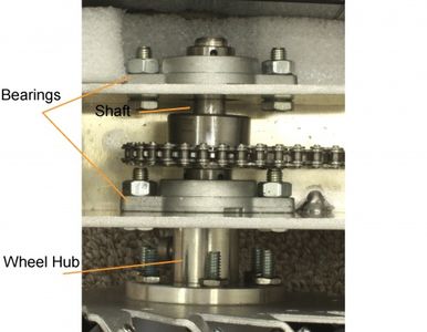

We used four 12mm shafts that were 100mm long each. Each shaft has two flange bearings which hold it in place and reduce friction when the shaft is spinning.

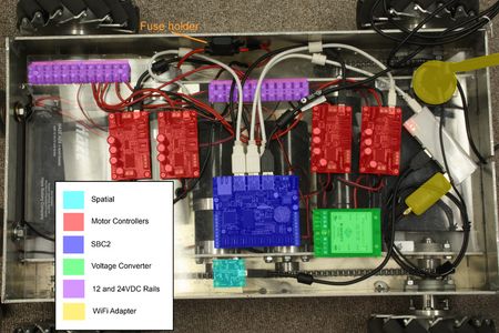

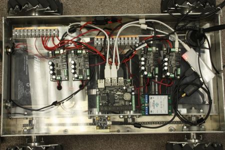

Step 6: Design and Assembly: ​Electronics
We cut a sheet of acrylic to sit on top of the motors and act as the mounting point for all of the electronics.
Since we have wired the two 12V batteries in series, we have a 24VDC output. This is good since the motors we are using are 24V motors, however this is also a problem since the SBC runs on 12V. To solve this, we have included a 12V output DC-DC converter (highlighted in green) so that our system has both a 24V and 12V rail.

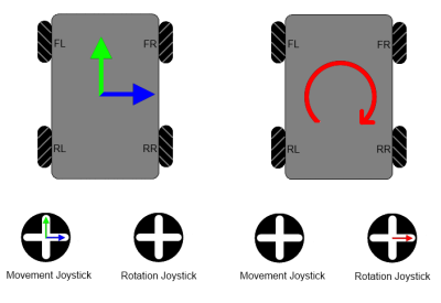

Calculate Wheel Speeds

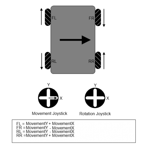

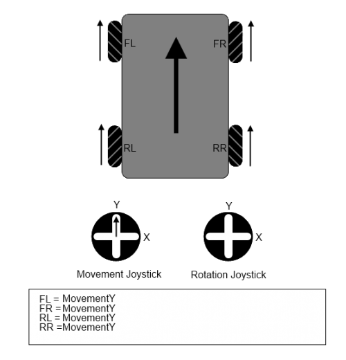

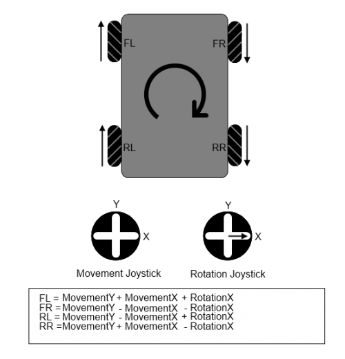

Once we have a direction, heading, and rotation we need to calculate how much power to give each motor in order to achieve the desired motion. In a normal vehicle this would be fairly straight forward but with mecanum wheel there is a bit of work involved.
void MecanumDrive(double magnitude, double direction, double rotation)
	//Limit limits magnitude to 1.0
	magnitude = Limit(magnitude);
	// Normalized for full power along the Cartesian axes.
	magnitude = magnitude * Math.Sqrt(2.0);
	// The rollers are at 45 degree angles.
	double dirInRad = (direction + 45.0) * Math.PI / 180.0;
	double cosD = Math.Cos(dirInRad);
	double sinD = Math.Sin(dirInRad);
	double[] wheelSpeeds = new double[4];
	wheelSpeeds[0] = sinD * magnitude + rotation;
	wheelSpeeds[1] = cosD * magnitude - rotation;
	wheelSpeeds[2] = cosD * magnitude + rotation;
	wheelSpeeds[3] = sinD * magnitude - rotation;
	//Only if any are > 1.0
	Normalize(wheelSpeeds);
	frontLeftSpeed = (wheelSpeeds[0] * m_maxOutput * frontLeftDir);
	frontRightSpeed = (wheelSpeeds[1] * m_maxOutput * frontRightDir);
	rearLeftSpeed  = (wheelSpeeds[2] * m_maxOutput * rearLeftDir);
	rearRightSpeed = (wheelSpeeds[3] * m_maxOutput * rearRightDir);
The first thing that might appear strange here is the magnitude = magnitude * Math.Sqrt(2.0); line. This is an artifact of how joysticks function. To better understand, have a look at the following diagram:
Since joysticks have a circular range of motion you run into the problem that you will only reach a maximum X or Y value when you are along the X or Y axis. So if you are on any heading other than 0, 90, 180, or 270° you will never be able to travel at full speed. By scaling the magnitude by the square root of 2 you can be sure that you will reach full speed on all headings, and since the wheel speeds all get normalized later you don't have to worry about exceeding the maximum velocity the motors can achieve.
When calculating the direction and speed to spin the wheels at based on the joystick input there are two common ways to represent a point on a 2d plane: Cartesian coordinates, and polar coordinates. To generalize our code to any controller we have used polar, though the algorithm can perhaps be more easily understood if we instead look at it in the more traditional Cartesian coordinate system. Let's again use the case of twin joysticks being used to control the robot:
By summing force vectors for each of the primary directions we can get a resultant vector that will be of the right magnitude and direction. Note that the diagram only shows directions for positive values of X, Y, and Z (MovementX, MovementY, and RotationX). For negative values the arrows would simply be reversed, the math stays the same. The last thing we do is normalize the values so they are all between a magnitude of 0 and 1, scale them by the maximum motor speed so they are a proportionate percentage of max velocity, and add in the direction modifier:
