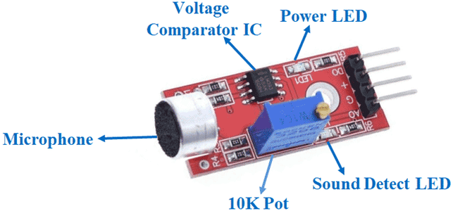

Here we are going to use some of the common components that every robotics hobbyist will have. In this we are going to use sound sensor which is built out of LM358 ic a condenser microphone a variable resistor to trim the values of range of the value given by the sensor to the microcontroller.
Sensor also has an onboard power led and also an onboard Status led which will blink whenever the sensor detects some sound
The sensor gives analog output which varies according to the sound input in the microphone also on the variable resistor as LM393 amplifies the sound acc to the variable resistor value.
*NOTE:- THIS SENSOR IS BASED ON CONDENSER MIC WHICH NOT A GOOD QUALITY ONE I RECOMMECD YOU TO USE THIS MIC FOR SOMR COMMON PROJECT BUT IF YOU WANT FOR AN PROFESSIONAL ONE I RECOMMEND YOU A GOOD QUALITY MICROPHONE AND AN BETTER AMPLIFIER IC.

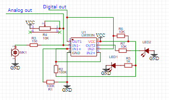

Step 2: SCHEMATIC DIAGRAM

Step 6: CIRCUIT DIAGRAM
First take the power lines onto the bread board from microcontroller VCC/5v-->+ line and GND--> - line.
Then connect the sensor on to the bread board and connect power to the sensor from powerlines using jumper wires.
Now connect OUT PIN OF SENSOR TO MICROCONTROLLER ANALOGl PIN A0.
Now connect LEDS to the breadboard – to gnd and + wire to analog pin A1 in series with a resistor to the microcontroller.
