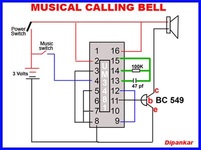

Step 2: The Circuit..
Solder the circuit as per the Circuit Diagram.
I have used a Discarded Mobile Phone L-ion Battery of 3.6 volts, which can be recharged ....
All the component are fitted into the PVC box.

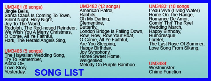

Step 3: Song List.
You can also use any one of these 5 Chips as they play different number of per-recorded songs as per the song list. The same Circuit applies to all the Chips named below.
UM 3481, UM 3182, UM 3483, UM 3484 and UM 3485.
Step 4: Pin Description of UM 3481.
Pin Symbol and description is given here as it may help you in making your own choice.
Connect the battery, press the Call bell Switch and enjoy the music….
