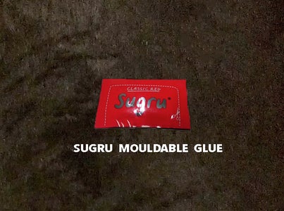

ALL THAT YOU NEED
I have used classic red colour in-order to differentiate sugru with wire, I recommend you to use sugru of same colour of the wire.
