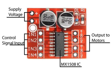

There are not many tutorials about the mx1508 online (like almost none). They are very cheap to use and quite small too. The best thing about them is that they support voltages from as low as 2v which makes them perfect to use with 3.7v motors as well as their capability to supply 1.5A per motor (perfect for dc coreless motors!!).

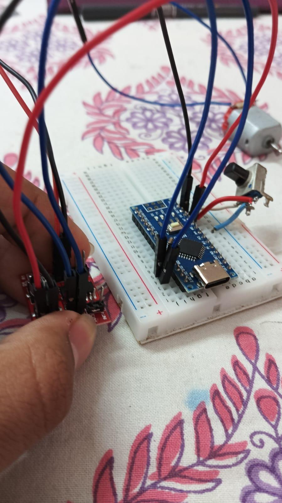

Step 1: Connections

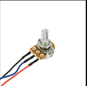

1) Arduino pin A5 to potentiometer middle pin
2) 5v to Potentiometer 5v and mx1508 +ve [Note that the motor should not take too much current, recomendation is to use a separate battery pack for the motor to prevent burning out your arduino)

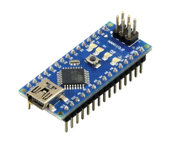

3)D9 to IN1
4)D10 to IN2
5) Motor A to Motor connection
Step 2: MX1508 Library
Install the mx1508 library by Cheng Saetern
https://github.com/Saeterncj/MX1508
This library allows us to easily use the mx1508 with arduino and motors. It has very basic commands such as
1)cwDirection = true/false allows us to set the direction of the motor
2)motor(A/B).motorGo(pwmvalue) this sets the speed of the motor in accordance to the analog input
3)MX1508 motorA(PINA,PINB, FAST_DECAY, NUMPWM)
Step 3: Code
#include <MX1508.h>
#define PINA 9
#define PINB 10
#define NUMPWM 2
const int potpin = A5;
// MX1508 schematics(in Chinese) can be found here at: http://sales.dzsc.com/486222.html
* MX1508(uint8_t pinIN1, uint8_t pinIN2, DecayMode decayMode, NumOfPwmPins numPWM);
* DecayMode must be FAST_DECAY or SLOW_DECAY,
* NumOfPwmPins, either use 1 or 2 pwm.
* I recommend using 2 pwm pins per motor so spinning motor forward and backward gives similar response.
* if using 1 pwm pin, make sure its pinIN1, then set pinIN2 to any digital pin. I dont recommend this setting because
* we need to use FAST_DECAY in one direction and SLOW_DECAY for the other direction.
MX1508 motorA(PINA,PINB, FAST_DECAY, NUMPWM);
void setup() {
Serial.begin(115200);
void loop() {
// put your main code here, to run repeatedly:
int potvalue = analogRead(potpin);
int pwmvalue = map(potvalue,0,1023,-250,250);
static unsigned long lastMilli = 0;
static bool cwDirection = true; // assume initial direction(positive pwm) is clockwise
if(millis()-lastMilli > 50){ // every 50 millisecond
if (cwDirection && pwmvalue > 100 ) {
cwDirection = false;
} else if (!cwDirection && pwmvalue < -100) {
cwDirection = true;
motorA.motorGo(pwmvalue);
lastMilli = millis();
Serial.print("Potentiometer value : ");
Serial.println(pwmvalue);
