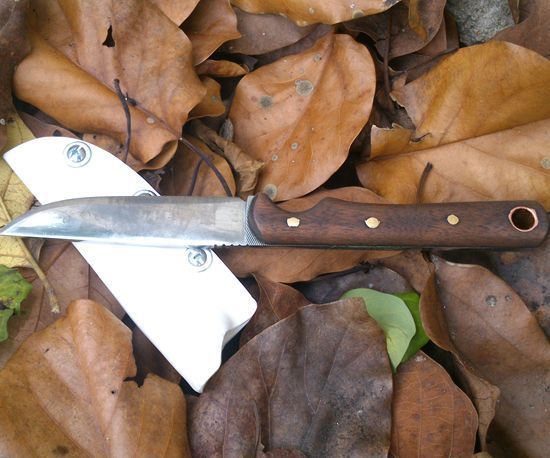

Introduction: MY BEST LEATHER WORK UNTIL NOW
I made this sheath with leather from old work boots.
I sander with sand paper the leather to take of part of the color and clean glue.
Also I used one piece of soft skin (new) for front and to make the leather cord.
That knife is also made by myself with and old saw, is a Big Ass Skinner and has oak handle.

Glue T piece to back leather piece and sew borders.
Joint front and back leather pieces.
I put 4 rivets on the edge to make it stronger
With a dremel I sand all borders.
Finally sew on the border and put ornaments with skin cord.
