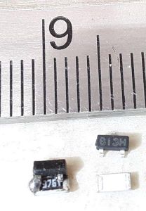

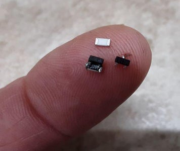

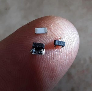

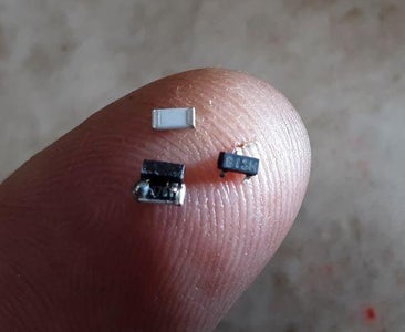

Step 1: JUST Add RESISTOR

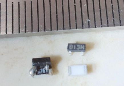

As per the drawing and layout circuit the only other component is a resistor. This will drive a small motor or switch a HR-12 module or anything less than 2 amps. By using a wire leg resistor the legs act as a heatsink as well as an easy way to connect to the circuit.
I use this switch for a gps module, HC-12, VPF camera, motion motor, and more. The typical circuit is the N type but to really stop all current draw I use the P type. This stops ALL Vcc that may have a stray leakage in the load. Mainly used in something with a battery.
Moser and Digitkey have these but both double the price with shipping. They also have 2,000 others to chose from. I got my N's and P's from China orders. I get the 50-100 lot price and pay about 3 cents each.
Be aware that these mosfets have a built in diode. This is needed in any circuit that creates a reverse EMF. Such as a magnetic coil. That would be a choke, motor, magnet...etc. A mosfet without this diode will be destroyed by the REMF.
Some notes on capacitors. The gate works well with a 1k resistor to a micro or direct connection. Sometimes a 10nf cap to ground is used. Any cap here only delays the rise time and turn on time of the mosfet. In a noisy environment this may be ok to use. The other placement of a cap is on the drain of the mosfet to ground. Again, in a noisy environment this may be useful. A value below 100mdf is best. All caps act like a dead short as they charge up. They will pull the Vcc down low enough to trip the brown-out detector in the micro and cause a reset. The start up to the 'load' also adds to this instant current draw problem. Unless there is a way of knowing of the reset, the circuit may preform in a way that is unpredictable. I had this ghost problem for a week before I found it. Many sensors have a 10-100mdf cap on board and a regulated Vcc supply. This makes the added cap useless.
