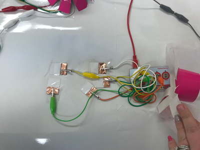

  3. Using copper tape, cut strips of 1 ½ - 2 inches. Fold over one end to create a “tab” for the alligator clip to be attached to.
  4. Lay the piece of copper tape on the back of the map over one of the squares that you cut previously (sticky side towards the back. Attached the alligator clip on the tab, and using packing tape attach it to the map.*
  5. Then, attach the other end of the alligator clip to the corresponding button on the MaKey MaKey.**
  6. Repeat 3-5 for each geographic feature.
  7. Take an additional alligator clip and attach it to “Earth”. This will be used to activate each continents features.
Educator Tip:
*Make sure that the pieces of copper tape do not touch one another. This may cause them to react simultaneously.
**I recommend that you do one continent per MaKey MaKey, and attach the clips to the map one continent at a time to avoid confusion.

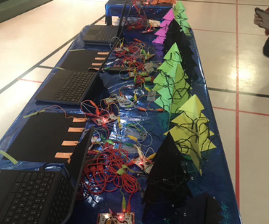

Educator Tip:
Our class used paper cups to stabilize the MaKey MaKey boards and alligator clips from the weight. See pictures for example.
