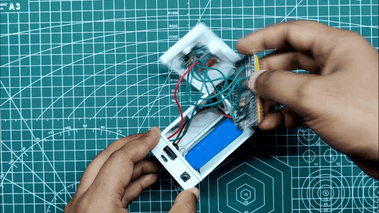

Step 9: FINAL ASSEMBLY
  • We first place the Li-ion Cell in its place.
  • Next, we add Front Lid on the bottom side and then cram the ESP32 Setup inside the main body.
  • We then close the Front Cover and then secure all the added parts by using six M2 Screws.
  • MacTempTosh is now completed.

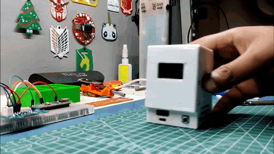

Step 10: RESULT
Here's the result, a working Temperature sensor that displays the current Room Temperature.
This meter senses Temperature via the opening in the left side of the body that exposes the Sensor IC Package, it can then sense the air around it and read the temp.
