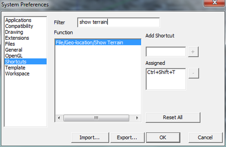

Step 2: Add "Show Terrain" Shortcut
As an oversight to Google Sketchup, there is no default button to show terrain. So the next step will be to add a keyboard shortcut to access this command. Go to Window\Preferences\Shortcuts and filter on the term “Show Terrain.” Select “File\Geo-Location\Show Terrain” and create the keyboard shortcut Ctrl+Shift+T. I know of no other way to access this command.

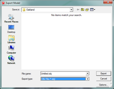

Step 8: Delete the Man
Sketchup provides a figure of a man to give an approximate physical dimension of your model. This figure needs to be deleted or it will be explored with your object data. After deleting the man, the final step is to export your 3D model, saving as an OBJ file.

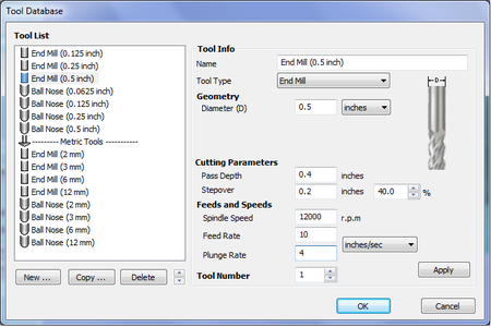

Step 10: Selecting the Rough Cut Toolpath
To begin, select the tool you will cut with. Since this project is cut in foam, I have selected a large bit, a high rotation speed, and a high feed rate and plunge rate. You will need to run this job MUCH slower if you are cutting denser material. To further speed up the cutting of this job, I have selected 3D Raster along the X axis, which calculates to a rough cut time of 1 hour 8 minutes.

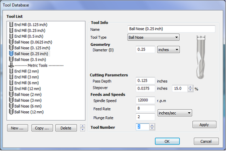

Step 11: Selecting the Finishing Toolpath
For this step I have selected a ball nose bit, again with a high cutting speed, feed rate, and plunge rate. Since I was cutting in foam, I was not too concerned with overheating the bit or moving the router too quickly. I think that these settings are about as fast as I could go, however, since I began to create some burr in the foam. The Cutout toolpath can be ignored because we are not cutting anything out in this project.
