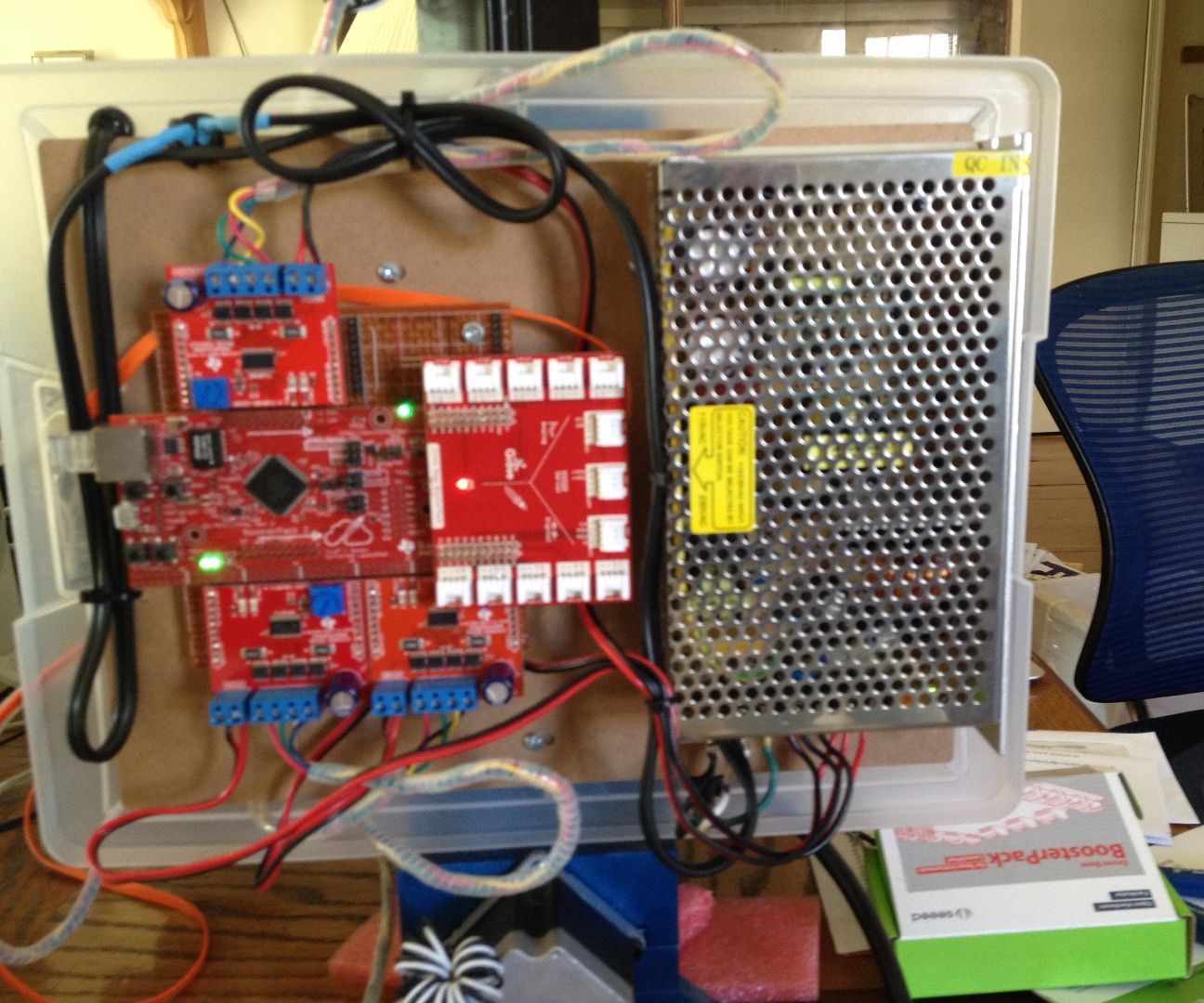

Step 1: My Control System
Comparing my motion control / motor driver configuration with my earlier configuration, you will note several changes:
1. My 36 volt 150 watt power supply was not going to work with my 176 watt spindle motor. I found a 36 volt 400 watt power supply on eBay for the same price. It is also the same dimensions as the 150 watt supply, main difference is the automatic fan. The supply arrived via USPS undamaged packaged only with bubble wrap and a padded envelop.
I moved the relay module from the hardboard to the side of power supply to provide more clearance between the AC and the circuit boards. A strong double sided foam mounting tape is working fine so far.
2. I am now using the full size of a 5" by 7" prototyping board available from eBay. This leaves me with space along one card edge for 0.1" pitch terminal blocks.These cute little blocks attach directly to the prototyping board and provide connections for the limit switches, probe, hall sensors and power relay module even more conveniently than the Grove Base BoosterPack that I was using before. The 0.1" pitch terminal blocks further provide secure connection with 0.1" pin header connectors. Note that I attach the fine wires for the hall sensor shielded cable to male pins, then insert the pins in a five position header, then trim the pin length to fit the terminal block, then insert and tighten the screw for each pin. I did the same for the ribbon cable connector to the relay module.
3. I replaced one of the TI BOOST-DRV8711 stepper motor driver boards with a TI BOOST-DRV8305EVM high power three-phase driver board for the spindle motor. The board has the same width but is 0.3" longer.
The 8305 uses a different SPI protocol than the 8711so it needs to be on different SPI controller so both BoosterPack SPI connections must be used. Note, the EK-TM4C1294XL has another two SPI controllers but using them would require adding additional connectors to the breadboard pinout area.
Running a BLDC motor smoothly at low speed, as I did in the demo, requires sinusoidal commutation. Only trapezoidal commutation is possible using the SPI interface. I use the SPI connection to set the 8305 to 3-PWM mode and then control it with 3 PWM µP outputs modulated for 1/64 micro-stepping.
