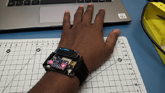

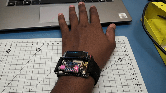

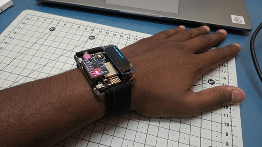

To train the data I'm using a python which trains the model and convert it to a C file which we can use with arduino IDE. You can get this file from my github repo and open the file 'Classifier.py' inside 'Python training code' folder, this code we’ll read the csv files and train the model to learn the gesture we recorded before. if you have different file names, just change the python list called fileName so it will train the model from your collected data.
After running this code a 'model.h' file we’ll be created. This file contains the trained model to identify the 3 gestures that we captured. If you would like to just test the model, paste your 'model.h' file inside the 'Testing gesture detection' folder and open the arduino file inside the folder. Then just compile and upload the code to your watch.
Step 11: Inferring the Model
Our ML algorithm doesn't learn anymore once the code is uploaded to the microcontroller, it just used the pre-trained model that we created earlier and this is called inferring the model.
Once the code is uploaded successfully make any gesture, the oled display should say what gesture you are performing. In my case the model worked 95% of the time, it just sometimes it suffers to find the right swipe gesture. Probably, the data I collected was noisy or maybe I wasn’t doing the motion right while collecting the data.
Anyhow 95% is still good for me, we can do so much with this gesture detection!
