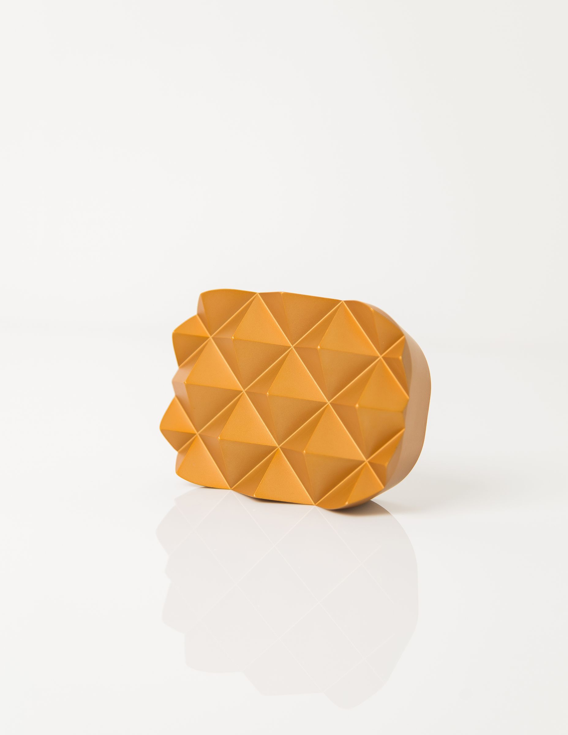

Here we have a "Noise Ring".
It's a ring design generated using F3App. Its output is STL and OBJ.
We can 3D print it but not machine it. :(
But we'll be able to soon! :)
We've used Autodesk's MeshMixer software to import the file. What you see here is an analytic tool within MeshMixer to view normal vectors as a visual.
What we're about to do is to reduce the number of facets (this one has over 15,000 and it makes Fusion360 a bit uncomfortable, so we'll need to get a handle on it).
Click Select > Then double click the object > Edit > Reduce (Shift + R)
Play around with the number of facets until you're comfortable with it. We chose something under 10,000.
