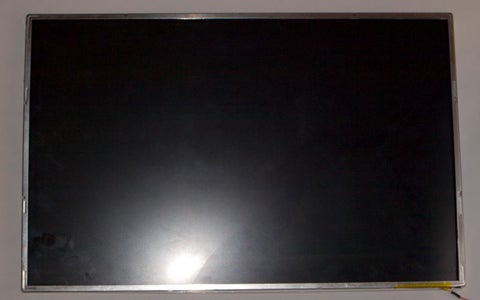

Step 2: Locate a Broken Lcd Panel
Locate an LCD screen that still faintly lights up, but is otherwise non-functional. If the screen does not light at all, it is most likely suffering from a worn out CCFL or inverter. In this case, you can try to purchase a replacement inverter or tube, but typically this is fairly expensive.
Broken LCD screens can be found on EBay. Look for 15"-17" monitors.
Step 3: Extract the LCD Layer
An LCD panel is made of three layers:
Sometimes the dispersion layers refuse to stay in the frame without the LCD layer in place. A small amount of clear packing tape around the edge of the frame will help solve this problem.
- LCD - the black colored panel that actually produces images (upper most layer)
- dispersion layers - there are usually three plastic layers that help disperse the light from the CCFL evenly over the entire panel
- a reflective panel - the last layer of the panel - the CCFL bulb is usually embeded or attached to this layer. Use extreme care when handling this portion of the screen. The CCFL is very thin tube of glass that is quite delicate. Also, it is filled with mercury vapor which is not so good for you or your brain. Don't break it.

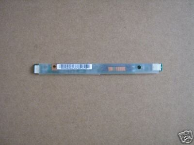

Step 4: Locate a DC-AC Inverter
The CCFL requires a fairly specialized circuit to drive it. LCD inverters can be found on EBay for about $12. Generic inverters will do the job just fine.
If you're salvaging a panel from a broken whole laptop or monitor, locate the small board that the panel plugs directly into.
If possible salvage the wire harness that is made for your inverter. You can remove the stock connector to provide bare wires that are easy to work with. The harness that connects to the DC in side of the inverter is most useful. Unless you have been extremely careless with the panel, the AC harness should still be connected to the CCFL tube.
In theory an inverter should be closely matched to the CCFL it will be used with. This will typically extend the life of the tube and board. This shouldn't be a problem for this type of project, however. As long as the inverter is for a tube of approximately the same size CCFL, it should work just fine.

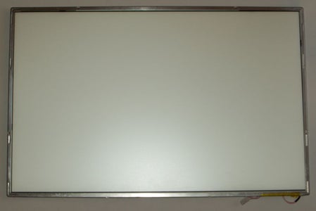

Step 8: Complete and Use the Light
I salvaged my display from a non-functional laptop, so I had the advantage of having most of the parts I needed at my finger tips. I disassembled the notebook for parts and saved a few bits to complete my light.
I used the following parts to make a more complete light:
- original screen housing with hinges
- heat dissipation frame

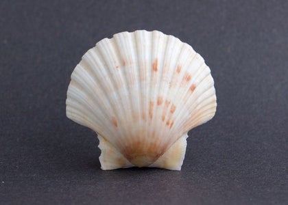

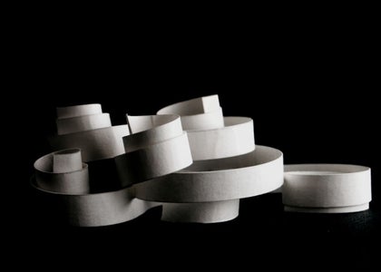

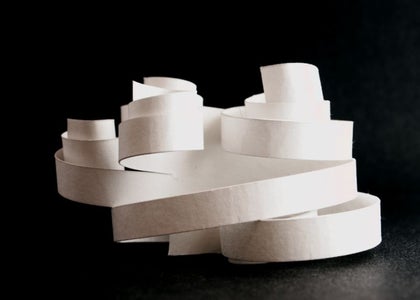

Step 9: Some Shots of the Light in Action
These are some shots that I took using the light. The light was oriented to the right side of the light tent and was the sole source of light for most of the shots.
The shots have been post processed, but only for black/white balance and contrast.
