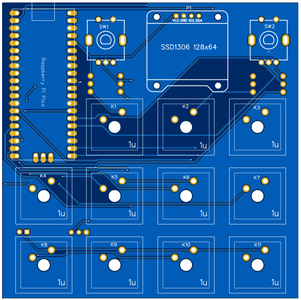

Step 1: Schematic Diagram
The schematic diagram is available to view here. The design is straightforward as each button was connected to a GPIO pin to the Raspberry Pi Pico. The reason for not using a matrix is due to limited space on a 10 x 10 cm board size, which meant individual GPIO pins could be used. This also means that diodes are not needed to prevent ghosting effect when pressing the keys. The board is kept this dimension to minimize the total cost of the board. The screen can be removed if more buttons are needed, but will require a new PCB design and updated code.

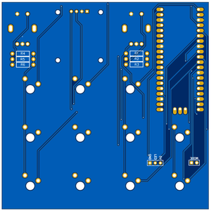

Step 2: PCB Design
The PCB design is simple which allows you to mount the PCB easily into different enclosures with the 4 mounting holes in the corners. The placement of the Pico was placed on the bottom layer which will be connected through header pins. If anyone in the community have suggestions on how to improve the layout or want to contribute reach out as I would like to see how this project can be taken further.

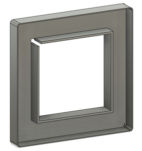

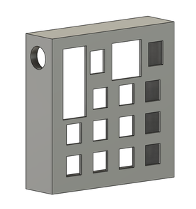

Step 8: Enclosure Design
The enclosure was made in Fusion360. The enclosure consist of two part the main body and bottom part which is used to diffuse the LEDs
