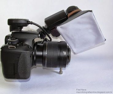

Step 2: Lenses and Coupling Devices
Now that you have your point-and-shoot camera ready, it's time to couple some lenses in order to magnify the subject you want to shoot.
Lenses:
To get into macrophotography (at least 1:1 magnification), we need to attach external lenses to the camera lens.
In my case, I used an old binocular of my grandfather (RIP). It has glass lenses: 4x30mm (4x zoom x 30mm diameter) as you can see in the pictures. I liked the results so much that I bought another one at e-bay to couple more lenses together.
The binocular lens diameter you'll be looking for must be larger than your camera's lens. But not too large or it will not couple optically in a good way. I've done some tests with largeer binoculars 16x50mm too, but it didn’t work well also. Do not use acrylic lenses, it doesn't work. Magnifying lenses also did not work well for me.
For me the best lenses were 4x30mm.
With my old Sony camera (very small lens) a 20mm telescope ocular worked nice also, with high magnification. As seen in the picture I drilled a wood pice, attached the ocular in the middle and attached the wood to a PVC adapter that fit my camera.
Coupling devices:
I aways used PVC pipes adapters as coupling device to the camera. You will find some adapter that will fit your lens and camera easily (or with minimum adjustments). The important thing is to hold the lenses next to your camera's lens without touching it even when you activate the optical zoom. It will avoid any damage to your camera mechanics.
You will have to paint inside black (matte) to avoid light entering and reflections. Externally you can paint in the same color as your camera.
It is important you try to close any possible light entering inside the device.
To fit the lens inside the adapter I used rubber rings (O'ring). If you want a definitive solution you can use epoxi glue.
Do some tests before finish the coupling device. For Canon and Fuji cameras I obtained better results inverting the binocular lenses (curved side at camera's direction). For my old Sony camera I used the straight side of the lens towards the camera.
