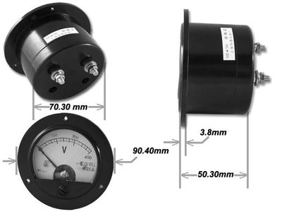

An anlogue 0-250volt meter (mains here in the UK),

The sloping front piece with the 'danger Will Robinson' meter on it had to be cut with a chamfer (angle) to sit neatly in the remaining space.

Finally the meter is wired in parallel with the bulbholder.
