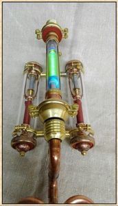

I now proudly present the „Mad scientist´s ionizer, a steampunked beacon light for time travellers" to you.
This light stand is also very suitable to explain and test the behaviour of noble gases in Physics education at school. All important parameters can be measured and testetd by the pupils.
Please take first a look at this video other small videos will follow at the different steps.

Step 1: The Pedestal
Ancient tripod stands for chemistry or physics with their screw clamps and all the strange looking equipment have been the model in my mind when I started this project.
My idea was that the stand itself should look like it comes directly from the laboratory bench of a mad scientist and so the story began.
Strange old resistors raise up in their acrylic glass columns, pretend that they handle with high voltage things, have been placed left and right aside the main tube holding the neon gas filled tube. Several switches, push buttons and sockets for banana plugs are integrated in the pedestal.
First the two plywood plates were cut with a jig saw, then milled circular and contured with the router. Later they wer painted black with acrylic paint.
Between top and bottom plate a ball bearing retainer made of laminated fabric was placed an covered with stripes of perforated copper plate from the inside. Three of the cage holes were filled with the piezo igniting push button and the two banana sockets in their brass made holders. So a crank inductor can be attached with banana plugs to light up the neon tube.
The bottom plate of the pedestal got an integrated battery box to change the AA-battery easily from the bottom side. All parts of the pedestal were screwed together with eight pieces of M4 brass screws. That´s why I drilled brassmade screw anchors into the bottom plate. At the downside of the top plate I fixed the flash unit pcb with a screw and also drilled in the main switch.
The brassmade one-handle built-in mixer was fixed with four screws M5 to the top plate.
Step 2: The Brass Stand
The one-handle built-in mixer from the scrapyard was cleaned, polished, covered with zapon laquer and then modified in that way, that I screwed a closing cap ¾“ in the biggest threaded hole. In this cap I cut a thread M 10 in to screw later the brass made ø 10 mm rod in. This screw connection was fixed additionally with epoxy resin. Through the mixer lead some runners to a central outlet ,12 mm in diameter which I used as hidden wireways.
The other two holes on top of the mixer formerly provided hot and cold water tubes. In these holes ø 10 mm, the two 180°coppertube bows fit perfectly in. They now lead down to the Mixer footplate and cover there two of the holding screws. These bows were covered with several brassmade knurled connecting nuts just for desoration.
Two brassmade T-fittings with an inner diameter of 10 mm were used as the central tubeholders. I cut threads M8 inside the middle hole to attach there the munsenrings for the main tube. Outside the T-fitting other munsenring parts could be fixed with screws to hold the acrylic glass cartridges later.
A combination of four 90 degree bows of 12 mm copper tube fittings was soldered with a blowtorch and small parts of 12 mm copper made tube in that way, that they later lead to the center of the Edison socket. In this tube the connecting wires from the neon tube run down to the pcb of the flash unit.
Step 3: Beacon Light Tube
The tubeholder of the neon gas tube ø18mm itself had been constructed in that way that I first covered the glassmade tube with a small acrylic glass tube ø 20 mm which fitted then perfectly in the milled coppertube ø 22 mm. After soldering and insulting the wires to the contact wires of the neon tube, the enclosing acrylic tube was sealed with hot glue at both ends. Inside this tube a very small wire -insultated with silicone- lead down from the top contact at the backside of the neon tube. This construction was then covered with the coppermade and milled shield tube. At least this tube was combined with the „E27 – centra type“ Edison sockets using small plywood slices glued with red fiber.
One of these edison sockets, the one which is connected to the downleading copper tube bows, got in its foot contact a hole ø10 mm for the wires which I drilled very carefully with a diamond drill. I needed a lot of water for cooling and mainly to prevent glass dust. Please wear a dust mask and safety eye protection while drilling this.
