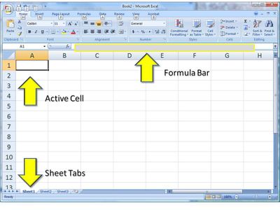

Start by opening up a blank document in Microsoft Excel. I am using Excel 2007, but you can do this in earlier versions too. Everything is the same.
You will only need to worry about three areas of the spreadsheet.
1) The active cell will be where most of the typing will happen.
2) You can see the formula from the active cell also in the formula bar. You may prefer to type things there, if your spreadsheet is getting too crowded.
3) We'll be using two sheets in the workbook. You can switch between them, by clicking on these tabs.

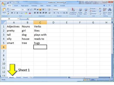

Starting with worksheet Sheet1, make a table of words, as shown. To start with, we'll only use nouns, verbs and adjectives. And only four of each.
Later I'll show you how to add more.

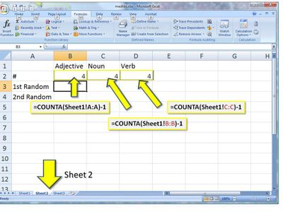

Our first formula will return the number of words in a particular column.
1) In cell B3 (column B, row 3), type this formula EXACTLY (copy-and-paste from this page, if possible)
=COUNTA(Sheet1!A:A)-1
This tells Excel, "go to 'sheet1' and count all of the non-blank cells in column A. Subtract one from that" (for the label in the first row.)
2) Copy this formula and paste it into C3. Change the A:A part to B:B
3) Copy to D3 and change A:A to C:C

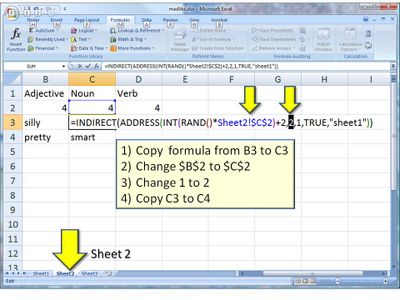

Now that we are successfully generating random Adjectives, we can do the same formulas for Nouns and Verbs
1) Copy formula from B3 to C3
2) Change $B$2 to $C$2
3) Change 1 to 2
4) Copy C3 to C4

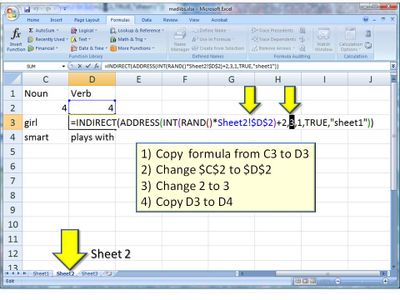

1) Copy formula from C3 to D3
2) Change $C$2 to $D$2
3) Change 2 to 3
4) Copy D3 to D4

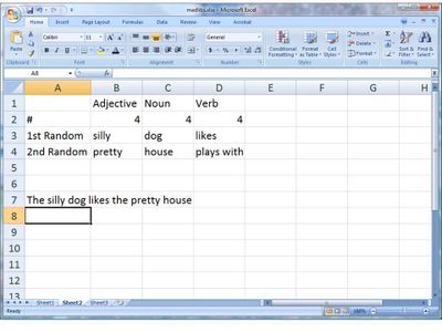

You should now have a table with a bunch of random words on it.
(Have you noticed that the random words change everytime you change something else on the spreadsheet? That is the coolness of the RAND function. It updates whenever anything in the spreadsheet is changed. :-)
Step 5: Form a Sentence

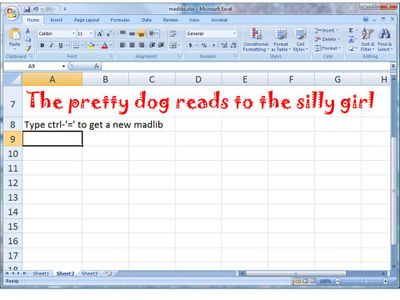

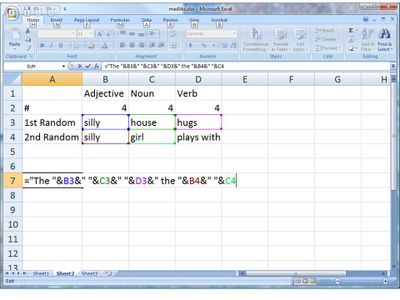

Now we want to string these words together in a sentence. Type this formula EXACTLY, in cell A7:
="The "&B3&" "&C3&" "&D3&" the "&B4&" "&C4
When you hit return you will see your first random sentence! Want another? Hit 'CTRL+='. (That's the CTRL key, plus the '=', at the same time.) Keep going! The randomness never stops.
How's it work? Excel mashed together everything in that line. The word "The " was smashed into the random word in cell B3, which was smashed into the space (" ") and on into cell C3, etc. Like a five word pile-up, fused together with those ampersands (&).

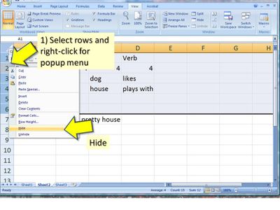

You can hide those rows, by
1) click the row labels and drag to select several rows
2) right-click on the row to get a popup menu
3) choose Hide from the popup menu

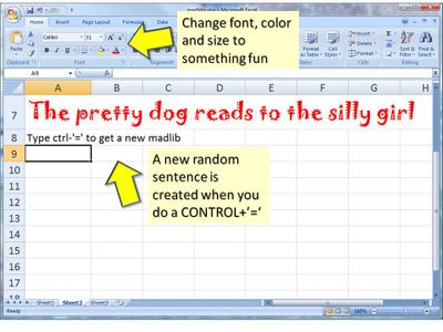

You can also find many text formatting options on the Home toolbar. I have lost many hours of my life, scrolling through the endless list of fonts that come with Microsoft Office.
In this example, I selected 'Jokerman'.
You may also want to add some instructions, so that your friends know what to do.

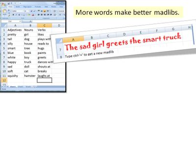

More randomness results from a longer list of words.
Add as many words as you can think of. Ask your friends for words. Add them to the lists in sheet1.

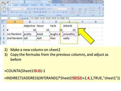

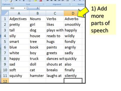

FIRST, add another column to sheet1. In this example, I am going to add some adverbs to my sentence.
SECOND, also add another column to sheet2
(you may have to 'unhide' these rows, if you hid them in a previous step. Right Click where the rows should be to get the popup menu. Select Unhide.)
Copy the formulas from the previous columns, and adjust as before.

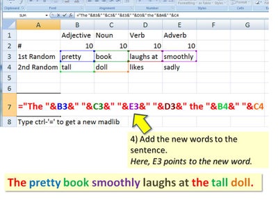

Thus, E3 should be:
=COUNTA(Sheet1!D:D)-1
E4 and E5 should be:
=INDIRECT(ADDRESS(INT(RAND()*Sheet2!$E$2)+2,4,1,TRUE,"sheet1"))
FINALLY, add the new word(s) to your sentence. I put my new Adverb in front of the Verb, as is proper.
="The "&B3&" "&C3&" "&E3&" "&D3&" the "&B4&" "&C4
Be careful to join everything with ampersands (&). Also make sure that there are spaces (" ") between words.
