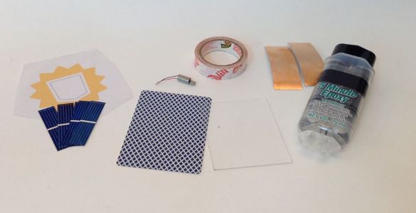

Step 1: What You Need
  • A playing card (although a piece of cardstock, cut piece of acrylic, scrap PCB, or really any flat material thinner than 2mm should work), available here
  • Double-stick tape:  any will work, but my favorite for all sorts of projects is called Window Tape by Duck
  • A couple strips of adhesive copper tape: a must for everyone's solar toolbox.  Readily available at art supply shops or on Ebay
  • A piece of acrylic or PET sheet smaller than your playing card: I am using a 70mm x 60mm piece of acrylic.
  • Five solettes*, like these from a random Ebay seller
  • A pager motor that vibrates when supplied with 0.5VDC- 2VDC, like these
  • Clear 5-minute epoxy that is designed to withstand temperatures of at least 90C (or 194F).  I've found the VersaChem 46409 works particularly well
  • Hot glue and a hot glue gun
  • Teflon sheet (optional)
*If you're new to making photonic robot lifeforms, you might be wondering what a "solette" is.  Solettes are little pieces of mono or polycrystalline photovoltaic silicon, laser cut or hand scribed into smaller pieces for smaller solar panels.  Basically, they are rectangular bits of the magical silicon inside solar panels that transforms light energy into electrical energy.  If that explanation is absolutely unsatisfying to you, your curiosity will be partially relieved by the wise words of Chill Solar Dude, here:  https://www.instructables.com/file/F4UXYJKHFWSTBW6

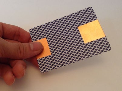

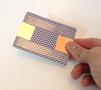

Step 2: Add the Copper Tape to the Playing Card

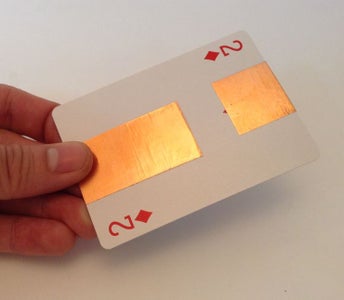

You'll need two pieces of copper tape, to pickup the two poles of the solar panel you are assembling.  Cut, peel, and stick.  Rub it down with the back of your fingernail for that retro gloss finish.
Since we will be making a 2VDC panel (with one solette as a dummy conductor) and this requires 5 solettes, I spaced my copper tape by about 45mm (or 1.75") along the length of the card, with the copper tape coming in at around 25mm wide (or 1").
>>Note that the copper tape conducts best along the surface without the adhesive.  It doesn't conduct reliably through the tape thickness.

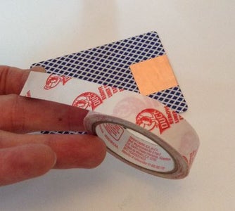

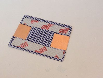

Step 3: Lay Down Your Double-sided Tape
Flank your copper tape with some double-sided tape.  Just make sure not to overlap the double-sided tape with the copper tape, since that can cause a reduction in power of your completed solar panel.

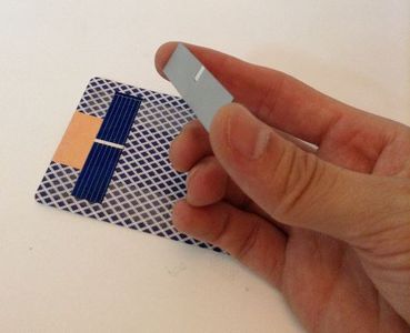

Step 4: Shingle Your Solettes With a Whistle and a Tap
This is the step where the solettes get combined together in series.
In previous Solar Pocket Factory instructables I've shown a couple techniques involving superglue or conductive paste or soldering.  For the Photonic Madagascar Cockroach you don't need any of that, and you'll be doing something far simpler.  Basically, you need to overlap each solette in a shingling pattern, without any adhesive or solder joints.  Pressure along is what will complete the solar circuit.
This pretty pretty sunset infographic is compliments of a guy who drinks sunshine for breakfast and craps out pure light by dinnertime.
Theory:

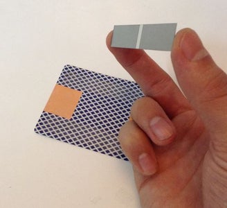

Each solette, or any chunk of mono or polycrystalline PV silicon for that matter, outputs around 0.5 - 0.6VDC, which is not enough voltage to do very many useful things.  So, we need to combine enough of these solettes together in series so that their voltage outputs add up.
In order to make the pager motor spin and create the vibration necessary to propel the robot cockroach we need to supply around 2VDC to the motor's input wires.  This means we will need 4 solettes in series (or, 2.0Vopen).  The solettes I recommend using are 13mm x 52mm in size and each will output Im (or, the max current at the maximum power point of the cells - about max power point here: http://en.wikipedia.org/wiki/Maximum_power_point_tracking) of around 150-200 mA per solette, far more than is necessary to make the pager motor spin at full velocity even on a cloudy day.  So, since we are combining the solettes in series, the voltages add up, but the current does not.  Or, to put it another way, 4 of our solettes in series will output 2.0VDC and 150mA-200mA on a nice day and about 1/3 that on a cloudy day.
Back to the solettes:  The (+) output is the grey underbelly of the first solette in your shingled stack.  The (-) output of the series connected shingled lineup can be accessed either at the bus bar or white silver ink runners on the blue top surface of the final solette in your stack, or by using a "false" solette that doesn't produce electricity but just serves to bring do the top surface connections to a solette underbelly. This is the easiest and cleanest approach and it's what I show in these photos, and is worth the sacrificial solette in my estimation, just for the simplicity it provides.  So, ignore what I wrote in the paragraph above -- you need 5 solettes if you are using one as a basic conductor.

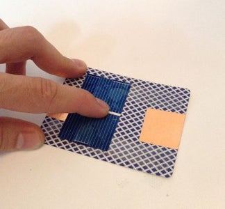

Practice:

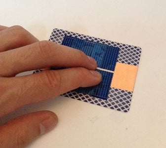

For your first solette, make sure it has part of the white bus bar underneath the solette in contact with the copper tape.  I used a full bus bar solette in this example.  And just overlap the bus bar under the solette with coppertape by at least 2mm to ensure a good stable connection, and the two strips of double-sided tape you laid down will hold it in place.  Blue side up facing the sun.
Now, overlap your second solette by 2mm with the first solette you placed.  Again, at least some of the white conductive bus bar under your second solette needs to be in contact with the white bus bar on the top of your first solette to ensure good conduction.  (this isn't actually strictly true for shingled panels....but more on that in a future instructable).  Repeat this shingling for solettes #3 and #4.  The fifth and last solette you place will need a full bus bar on its underside, to make sure the top of solette #4 gets electrically connected with the copper tape on what will be the (-) side of your panel.  This last solette is really just acting as a conductor, and a piece of aluminum foil or folded copper tape would work as well -- but using this "false" solette gives me the most reliable results and I highly recommend it.

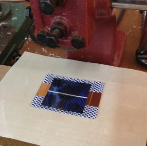

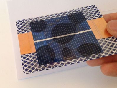

Step 5: Encapsulate and Cover

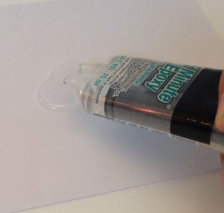

To protect your soon-to-be photon-driven little shop of horrors, a dab of 5-minute epoxy with a sheet of acrylic will do the job.  Epoxy is generally not the best choice for making microsolar panels, since it yellows in the sun as a result of UV degradation.  But, acrylic blocks out UV, so this 1-2 combo punch can make cheap, long lasting panels.
Or, so the theory goes.  I actually haven't tested this type of panel for more than a few days.  Let me know whether this theory matches reality or not!

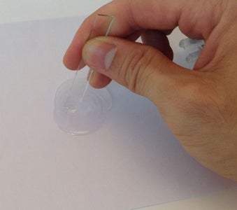

Just mix up the epoxy -- about 2mL will do just fine, since it will get spread out in the next sub-step.
Blob the epoxy over your solettes.  Add the acrylic topsheet (I used 1mm thick acrylic, but thinner or thick acrylic works fine too).   The acrylic sheet should just cover your solettes with several mm of border, leaving around 20mm of uncovered card on either side, as pictured.  I am using a 70mm x 60mm piece of acrylic.

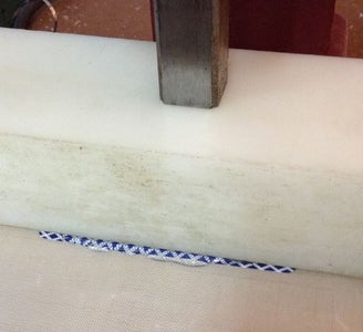

And then put 10-20 lbs of mass on this card-solettes-epoxy-acrylic sandwich.  I've been using about 15 lbs reliably (which translates to about 2 psi of pressure on the panel).  Also, you should use something non-stick separating your compression weight from the panel, lest your bug get squashed irreversibly forevermore.  I used a sheet of teflon myself.
Let the sandwich cure for about 10 minutes, then remove the weight and voila!  Your panel should now put out around 2.5Vopen and 150mA - 200mA Isc in full sunlight.  Even a bit less current from the panel will work fine for powering up the pager motor full tilt, since the motors only consume tens of mA at 2VDC.

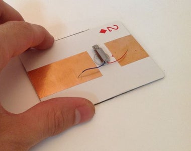

If you're using the asymmetric mass variety, center the mass in the center-ish of the back of your playing card.  Add a dab of hot melt glue and then mount the pager motor's body on the hot melt, taking care not to get any hot melt on the rotating mass.  If even a dribble of hot melt gets onto the mass, your roach will likely be bellyside up before you're out of the gate.  So take care at this stage with the glue.
Step 7: Solder the Pager Motor to the Copper Back Contacts
Copper tape is wonderful to solder onto.  Since kids like to grab real and robotic insects, I used lead-free solder and just got my soldering iron to 350C and the joints are a dream.
I found it generally doesn't matter which wire goes to which piece of copper tape, (+) or (-).  Maybe it does for some motors.  If it does, then just match your red wire on the pager motor to the piece of copper tape under the very first solette you placed, since that will be the (+) of your panel.
