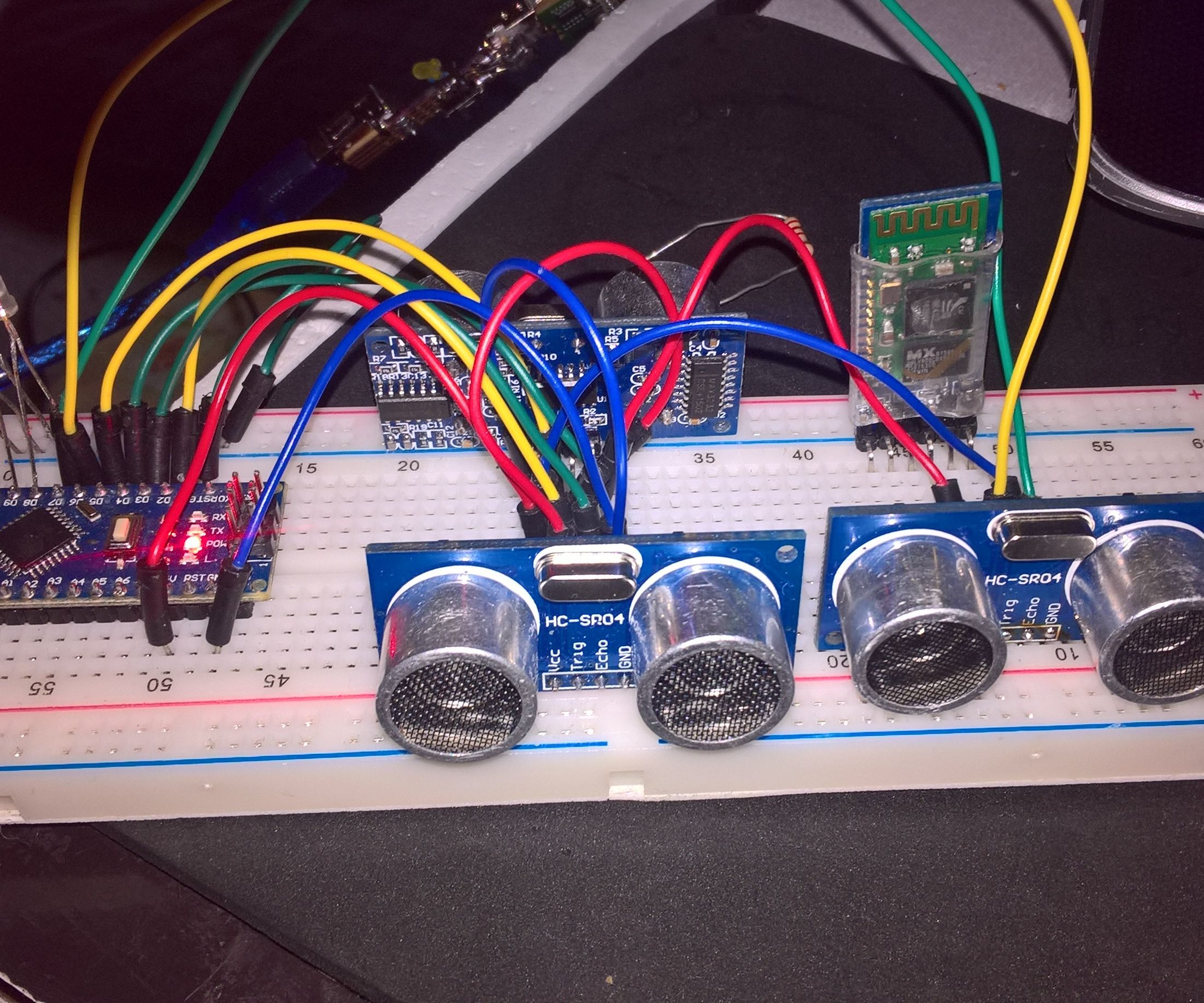

I used an Arduino Uno/Genuino for this construction, it has the wider base and a few more pins to play with. Apart from a couple of mods for turning it on and off, motor plug and Bluetooth placement, the connections to the pins are straight forward when using the Arduino motor shield. The servo and IR detector(power) are on the servo pins as labeled on the board. Bluetooth Rx and Tx are connected to A2 and A3 as digital pins, A1 is the sensor detection, A0 is used just to confirm connection between the to Bluetooth devices. via led.
When setting up the Bluetooth for both the MaddyBot Receiver and Remote Sender, they need to be setup as slave and master respectively. It can be a bit nightmare-ish getting that bit done, so patience is more than a virtue.

I'm using an Arduino Nano, because somehow I buggered up the USB port(I think I shorted it, in my experiments), so I directly connect to D0 and D1 to upload my code, not forgetting to keep reset low and release when IDE says uploading to board. Bluetooth is on D10 as Tx and D11 as Rx. Keypad is straight on D2-D9.
One thing to check at least is that if your Bluetooth isn't communicating, try swapping Rx and Tx, If you have your serial USB port still intact(like I haven't) then uploading to the Arduino via USB is as usual.
