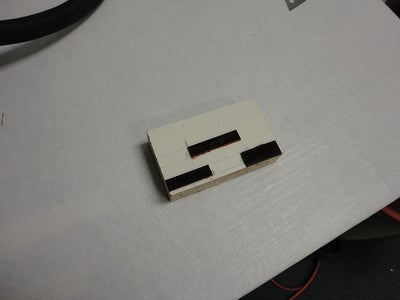

Next, I glued the back of the rubber stamp to my wood block, but only on the areas with lettering. After putting some pressure on it and waiting about 15 minutes, I took an exacto knife and cut out everything but the written areas. This helps to minimize accidental ink exposure on the paper when you're stamping.
Ultimately, you end up with mostly background wood and small segments of rubber that have your embossed images. After some research, I decided on pigment ink boh because it apparently applies well, and it remains moist for a few seconds. This gives me enough time to cover the paper with embossing powder. After that, I remove all the extra powder, tap on the paper to get the last bits off of everything but the ink, and head over to the heat gun.
Embossing powder is heat activated, meaning that the crystals attached to the paper by way of the ink melt into one glossy unit when the gun is placed over it. This has the interesting effect of raising the lettering, so that what you end up with is a clean business card with shiny, black, and textured letting.
The picture here is of the stamp after a few uses. I wanted to wait to show the actual stamping process until I've had some practice and can produce something I'd be comfortable handing to someone.
