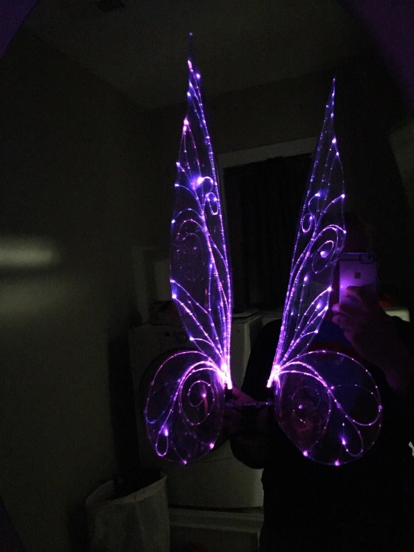

Introduction: Made With Magic Fiber Optic Wings
These wings are a mix of a two instructables with a dash of 3D printing.
Inspiration:
https://www.instructables.com/id/Lightwings-Fiber-O...
https://www.instructables.com/id/Custom-Disney-Worl...
While the wings are very cool by themselves, the real magic is wearing them at the Disney Parks (during holidays that allow adults to wear costumes, of course). The wings are made from vinyl, iridescent wrap, wire, and sparkle fiber optic wire. The harness is 3D printed, with the Made with Magic Minnie bows and AAA battery pack.
***EDIT***
I've added a YouTube video of the wings in action!

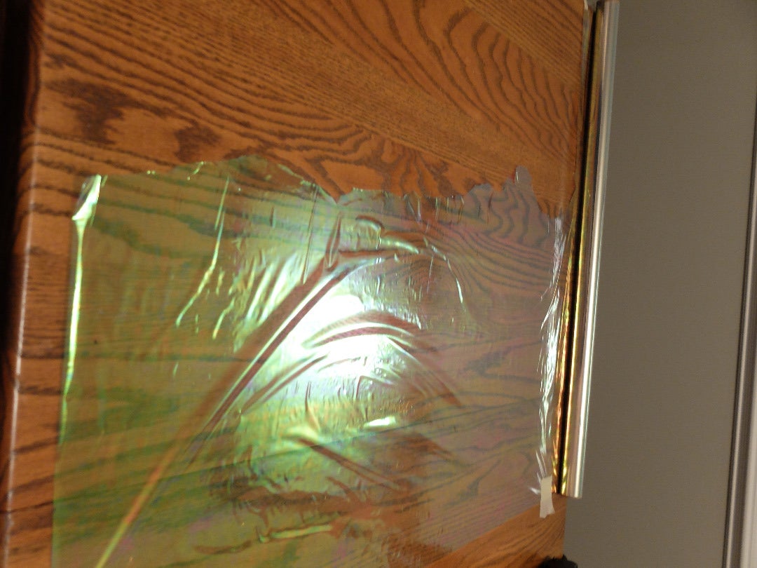

Step 5: Add Iridescent Wrap
You'll need to keep an eye on which side is which for this step.
- Unroll the iridescent wrap on to a flat clean table
- Tape the sides of the iridescent wrap to the table (a few pieces will do to keep it taut)
- Spray one vinyl wing (not near the wrap please!)
- Slowly roll the vinyl wing glue side down on to the iridescent wrap
- I found using a roll of wrapping pair to press it down gave the best result
- Cut the wing out of the iridescent wrap
- It's OK to cut a little bit of the vinyl off as well to give it a clean edge
Repeat the above steps, but make sure you spray the OTHER side of the vinyl. When you lay the wings down as if you were wearing them, you want the iridescent wrap to be on the same side.

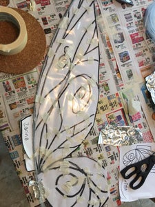

Step 8: Creating the Design
Now for the fun part
- Place the template under the wing
- Make sure the vinyl side is facing up and not the iridescent wrap
- Start taking your fiber optics and placing them to the corresponding lines on your design
- Use masking tape to keep the strands in place
- Gather the ends where the top and bottom of the wings meet
- Keep at least 3 inches extra
- Use foil to keep them all together neatly

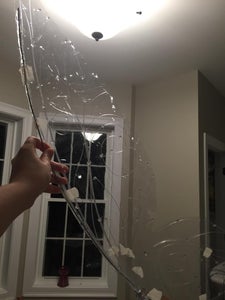

Step 9: Glue It Down
Once you've laid all the fiber optics over the design, it's time to glue it all down
- Squeeze some E6000 glue out
- Use a toothpick to grab a glob of glue
- Start by putting dots of glue on all of the ends of the fiber optics to keep them down
- The ends on the vinyl, not the ones in the foil
- Continue dotting the fiber optics with glue until they will not fall off
- See picture - not everywhere has glue. Just where it's needed
- DO NOT glue right next the bundle of fiber optics in the foil. We'll do this in a bit

Step 14: Go Forth!
And that's it!
The harness works by weaving a bra band over the wires and under the battery pack to keep it close to the back. The IR sensors in the Made with Magic Minnie Bows are able to receive signals through fabric and will interact with the shows and rides in the parks!
Please let me know if you have any questions!
