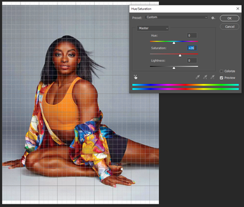

Step 3: Edit Your Photo

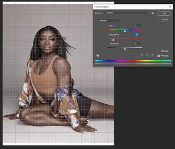

The photo is what will grab the attention of a potential buyer first, which is why a designer must make it appealing to the eye and encourage the viewer to want to know more. As we researched earlier, the most noticeable covers have images that play with contrast and/or vibrant colors. The colors and drama of a magazine cover photo evoke emotions in viewers, so think about what you want your photo to convey: If it is a serious or negative topic, decrease the saturation. If the goal is to reference something positive or eye-catching, increase the saturation. Much more can go into the visual effects of the image and the emotion it conveys, such as playing with shadows, but for today's lesson, we will play with the saturation of the colors.
- Select your image in the Layers panel
- Image > Adjustments > Hue/Saturation
Practice using your creativity. Do not change the saturation too drastically or the image will appear unprofessional and unattractive. The art is in the subtlety.

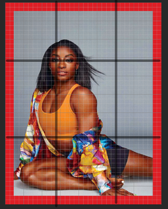

Framing is an important step in communication. Effective framing will guide the eyes where you want them to go. This step is where the grid comes in handy. Create a border around the magazine (using a border is a stylistic choice by some magazine companies to be recognizable so people are more likely to pick up their magazine). TIME Magazine and National Geographic both follow this technique. If you wish to duplicate one of those magazines, follow this CMYK guideline:
TIME Magazine red- C:6 M:100 Y:100 K:1
National Geographic yellow- C:0 M:28 Y:96 K:0
To make the colored border, select the Rectangle Tool on the sidebar.
- The settings should be: No fill; red or yellow selected for the stroke
- Drag from one corner diagonally to the opposite
- Set stroke size to 140 px
To align your image with the rule of thirds:
- Select your image and change the size of your image. Leave space for your text, but make sure your image is big enough to catch attention;
- Edit > Transform > Scale
- Use the Move Tool on the sidebar to align the focal point (ideally, the eyes) with one of the intersections in the rule of thirds. Visualize the grid dividing the image according to the rule of thirds.
Clean up the look.
- Mask the photo in order to create the classic white edge between the outer border that we added and the image
- Select image > Rectangular Marquee Tool (on side panel) > Click and drag around the subject so that there are two units of grid surrounding your image on all sides > Add layer mask
