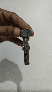

Hi Iam Adarsh and Iam a first year diploma(Electronic ) student.This was an attempt to make a simple self screwing bolt with minimum tools and effort. I first saw this device in a youtube video. It was realy amazing to watch the trick and it seems quite easy to make also.But making an exact copy was impossible without a metal lathe, so i made some changes and managed to make a working model.This thing works with the help of a mobile phone vibration motor. Iam not sure about the sciences behind it's working but the motor vibration some how move the nut in one direction until it screws or unscrews it self.Changing the polarity of the cell will also change the direction of the nut spinning.

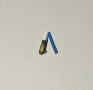

Next step is to make a small switch that will be activated when it's close to a magnet. There are special switches called reed switch available for the same purpose but i was not able to find a small one that could fit inside the bolt head,so i made one myself to make this first you need a small plastic piece. I used plastic from medicine strip for this. Any type of plastic would work only thing to take care is the small magnet using for this trick should be able to move it down and it should spring back to its orginal place once the magnet is removed. So cut a small plastic piece bend it from the centre to make a V shape.It should keep this shape for the switch to work two small copper pieces are used as the contact plates. Thin wires are soldered on both pieces. and for the magnet to make the attract the contact plate a small nut(any magnetic metal piece would work)is glued on top of it as in the photo.check this switch with a magnet and multimeter to make sure it's working correctly. metal on top will get attracted to the magnet, which will move down make the two copper pieces in contact thus completing the circuit.here the most important part is the plastic piece it shuld be thin enough to move down with the magnetic force and strong enough to spring back to its orginal shape when the magnet is removed. Plastic from tablet cover or packing cover works the best. Or you can just skip the whole step and use a reed switch and hide it inside the body of the bolt this will be much easier to assemble. I tried mine with a reed switch but my magnet was not strong enough to activate the switch through the thick body of the bolt.

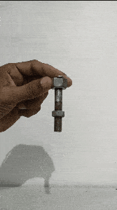

finally to performe the trick hide a Neodymium magnet in a band aid and stick it on your thumb. When showing the trick just move it around the bolt head.When the magnet gets near the switch it will get activated and nut will start to move by itself, until it fall down. You can repeat this as long as the battery last. Once the battery drain's open the super glued bottom panel recharge it using a li-ion charger and glue it back on.and that's it The magic bolt is done!.
This one is not a perfect magic bolt it's just a proof of concept so there are some problems with it like some time the switch get stuck, battery drains fast, etc.

Edit:videos shown above are played at 4× speed It normaly takes 1.5 to 2 minutes to complete unscrewing
