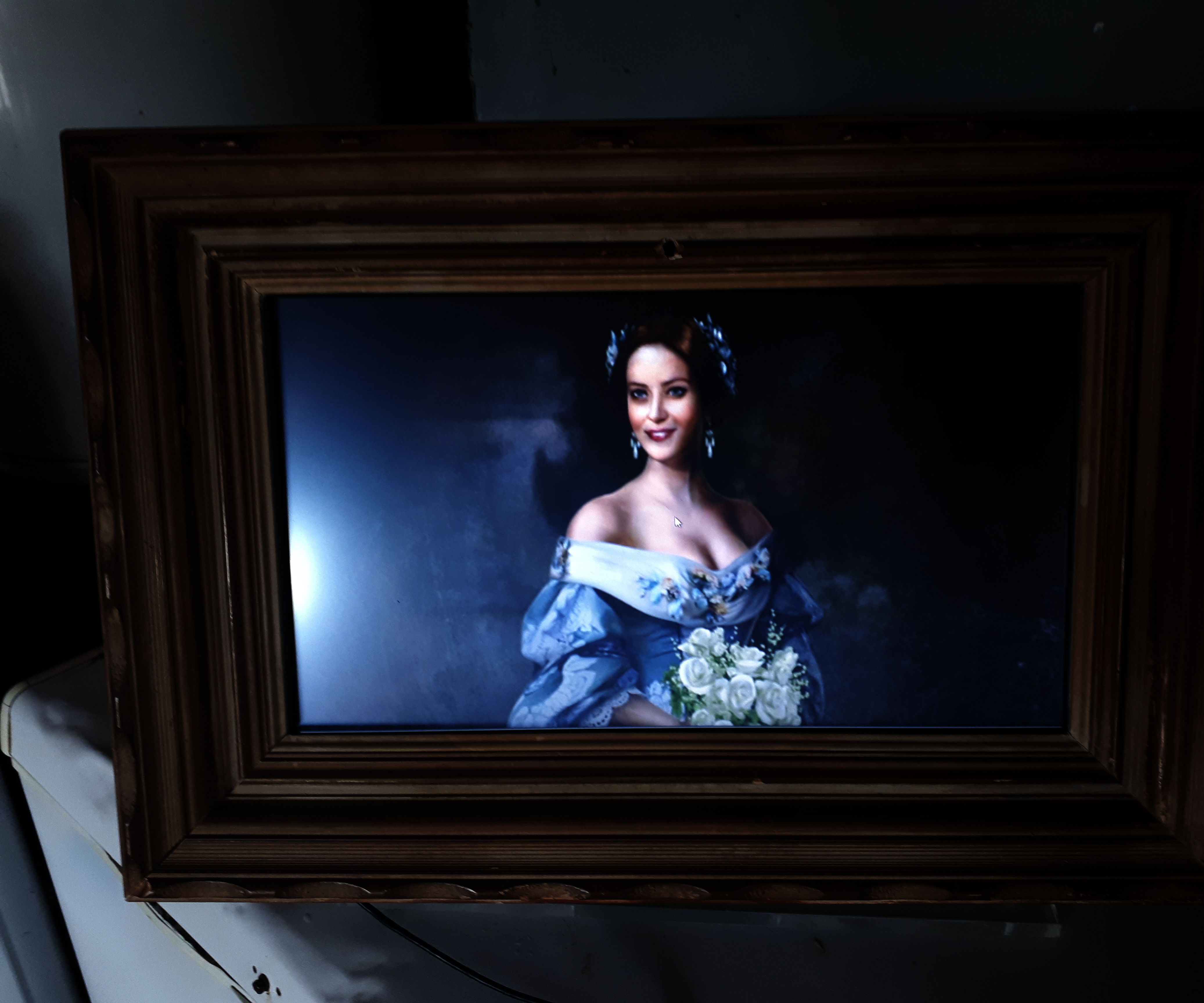

I wanted to change my live halloween portrait because it was starting to be known, I had an old Galaxy tab 10.1 that was sleeping, so I wanted to recycle it. I therefore offer you a "magic" mirror, which works with an Arduino and an application that I created with Appinventor, the application detects the state of the Arduino sensors using bluetooth and starts the video start. For the moment I only use two but there is the possibility of adding a lot more.

Step 1:
Place the film mirror, on the glass avoiding blowing bubbles to have a realistic effect.
Cut a black sheet to the size of the glass leaving a space of the screen size (real) of the tablet less than 1 cm on each side and 2 cm high
For the fixing I used metal plates, it is absolutely necessary that the on / off button is accessible.

Step 4: Test
First connect the arduino to the power supply (a charger socket), then start the Videoduino application which will automatically connect to the bluetooth module, place the sensors as close as possible to the mirror.
For create the videos, you can to be the actor yourself or create talking pictures with for example Crazytalk.
