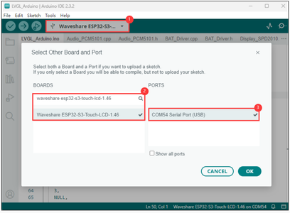

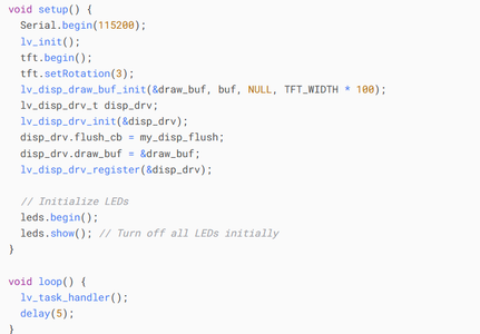

Step 2: Arduino Firmware
Introduction to Development Tools:
The ESP32-S3-Touch-LCD-1.46 currently supports two development tools and frameworks: Arduino IDE and ESP-IDF, offering versatile development choices. You can select the appropriate tool according to your project needs and personal workflow. In this project, the author has chosen Arduino IDE.
Arduino IDE is a convenient and flexible open-source electronics prototyping platform. It is beginner-friendly, allowing users to start developing quickly after minimal learning. Additionally, Arduino boasts a vast global user community that provides an abundance of open-source code, project examples, tutorials, and rich library resources. These libraries encapsulate complex functionalities, enabling developers to implement various features rapidly.
Install Dependencies:
- In Arduino IDE: Tools > Manage Libraries > Search "LVGL" > Install v8.3.
- Add TFT_eSPI library and configure User_Setup.h for your LCD.
Code: Interactive UI with Animations

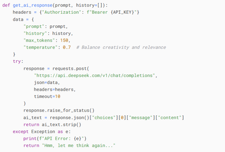

Step 3: Python Backend (DeepSeek API + Serial Communication)
DeepSeek builds powerful foundation models capable of advanced text generation and comprehension, and provides developers with API access to its sophisticated AI systems, offering both cloud-based solutions and potential edge computing implementations. What sets DeepSeek apart is its exceptional bilingual capabilities in Chinese and English, along with industry-leading performance in language understanding and logical reasoning. These models are particularly well-suited for creating conversational AI applications like the Magic Mirror Buddy, as well as various content generation and knowledge management systems.
API Integration
1、Install Required Libraries
2、Code: Context-Aware Chat with Error Handling
