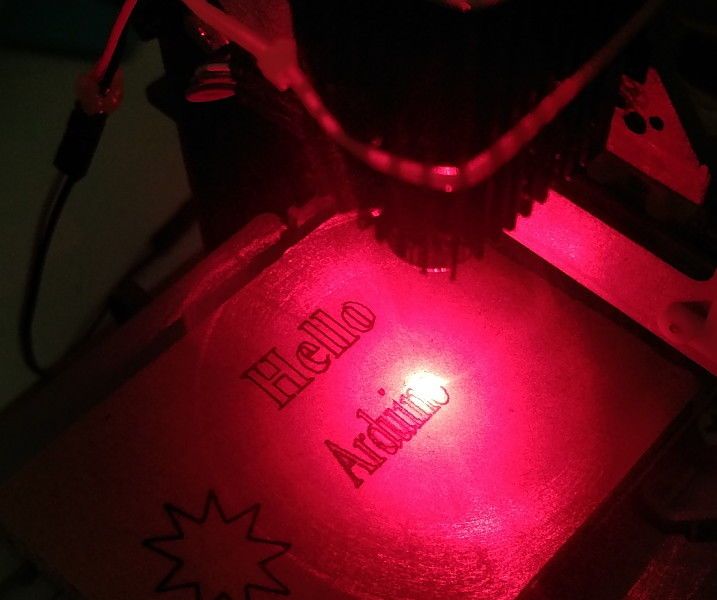

First, you need to prepare a wooden or cardboard box to install the Arduino UNO controller and all the sensor modules. There happens to be a wooden candy box in hand. It's a packing box for Spanish Pablo Rolled Sugar.
