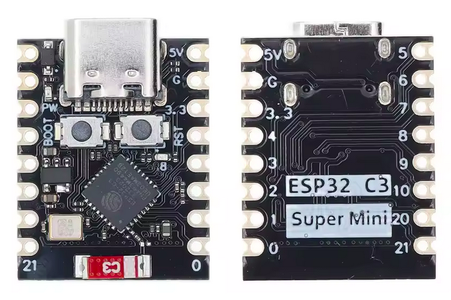

  2. 1x ESP32-C3 (https://www.aliexpress.com/item/1005006406538478.html)

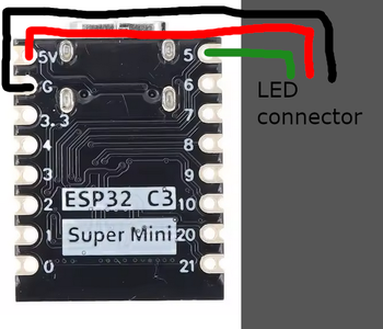

Step 3: Connect Everything
The electrical connections are simple too:
  1. Solder the LED connector as shown in the image.
  2. Connect the two LED panels together to form a single 8x64 matrix.
  3. Connect the ESP to the batery pack with USB cable
One LED connector should remain unused.

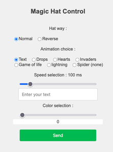

Step 4: Controling the Hat
To control the hat, connect to the Wi-Fi network it creates, then open a browser and go to 192.168.4.1 to access the control page, just like in the photo.
