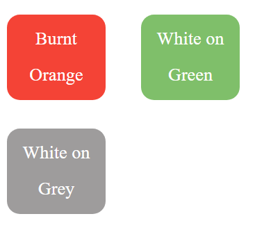

In order to control Amazon's Smart Plug with a webhook (HTTP request), you need to sign up for this third-party skill named Voice Monkey. Voice Monkey creates virtual doorbells in your Amazon devices. Alexa routines will, when triggered by the virtual doorbell being clicked (by the webhook), turn on a smart plug, a smart light, or any other Alexa device. The photo above shows my "monkeys". 0A turns the light on, 0B turns the light off, and so on.
Sub-Steps:
  1. Open the Alexa app.
  2. Click on "More" -> "Skills and Games" and search for "Voice Monkey".
  3. Enable Voice Monkey and create an account.
  4. On a computer, open Voice Monkey and sign in.
  5. Click "Manage Monkeys" -> "Add Monkeys" and add two monkeys for every gesture you trained in step 1. (I trained two gestures and therefore added four monkeys.)
  6. I named my gestures "0" and "1" in Google's Tiny Motion Trainer. I created "0a" to turn a device on and "0b" to turn a device off with one gesture, and then I created "1a" and "1b" to turn another device on and off with another gesture.
