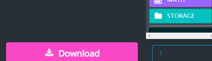

  15. Once you are done, plug in your CPX to your computer. Press the restart button, and wait for the lights to turn off.
  16. Click the download button, and copy it to your CPX.
