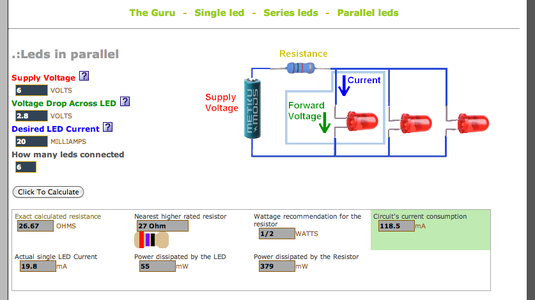

You will need to do a little math to figure out your LED arrangement. LEDs are sensitive to to much electric current, so we use resistors to limit the current flowing through them. Considering that I decided to add 72 LEDs to a hat, I did not want to have 72 LEDs and 72 resistors. I decided that it would be more efficient to wire the resistors in parallel. In other words the LEDs would all share a (+) positive electrical connection and a (-) negative electrical connection with one resistor.
Not being the math whiz I once was, I searched the web for an LED calculator for a Parallel circuit and I found exactly that.
There is also several Instructables on the topic. Here is one: https://www.instructables.com/id/LEDs-for-Beginners/step8/Wiring-up-multiple-LEDs-in-parallel/
