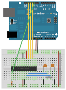

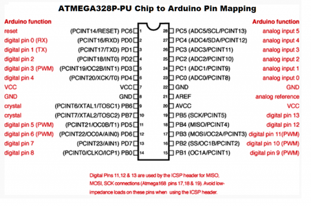

Step 3: Programing the Atmega 328 IC
You guys would be thinking that why this step came so early. It is rather come later, somewhere at the end of the whole project. The answer to your question is that, once we solder our Atmega on the PCB, it would be difficult for us to program it using an Arduino or through FTDI breakout. You need to solder the connections coming from your programmer and after programming, desolder them too. You would also be needing a new pair of crystal and ceramic disc capacitors so as to program it on breadboard, therefor it is better to program the IC in the starting rather than going through so many problem just to program the IC.
So start by placing the IC and programmer(In my case an arduino nano board) on the breadboard. Before programming,we need to attach a crystal and some capacitor to the IC whose connections are given below:
  • Short pin 9 and 10 through a 8 MHz crystal
  • Short pin 9 and ground through a 22 pf ceramic disc capacitor
  • Short pin 10 and ground through a 22 pf ceramic disc capacitor
  • Short pin 1 and vcc through a 10K resistor
  • Connect pin 22 and pin 8 to ground
  • Connect pin 7 and pin 20 to vcc
Before connecting your arduino board to IC, you need to upload a program to it named as Arduino ISP. Your can find this program in File>Examples>ArduinoISP. Connections of Arduino board with Atmega 328 is given above. Upload the code given below to your microcontroller. But before uploading, change the programmer in your arduino IDE in Tools>programmer>ArduinoISP. Also import the IRremote library to your IDE. Zip file of the library is attached with this strep. Then upload the sketch normally.

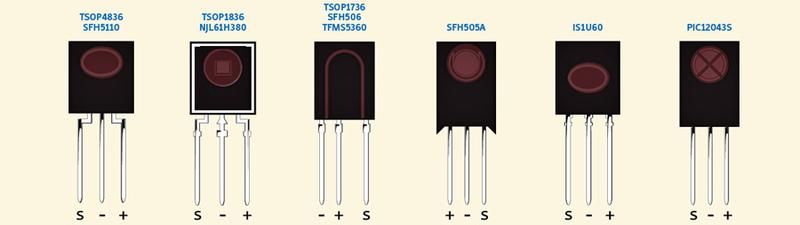

Step 6: Connecting the IR Module
The signal from wand to the receiver unit is transmit through the IR signals. I could have used one of those 433MHz RF module but IR signals have much more positive aspects than those normal RF modules. Some of them are listed below:
  • For producing an IR signal, we need an IR led. Those IR led are just like normal leds and can be easily fitted in front of the wand and could easily interact with the receive4r unit. But in case of RF module, the transmitter module must be hidden inside the wand and the walls of the wand would act as a barrier to the RF signals and cause interruption
  • IR modules are much more cheaper than RF module
  • RF signals are interrupted by your home Wi-Fi and other wireless networks. But there is no such issue with IR signals.
Now I think that much data would be sufficient for you to understand why it is better to choose IR module over RF modules. Now coming back on the IR modules, all IR transmitter are almost same but IR encoder or receiver come is lot of different packings. The one used by me is TSOP1736. Be sure to check the package type of your IR receiver before making the connections. Pin diagram of TSOP1736 is given in the images above. This receiver is not jump cables friend so how have to make a small connector for it. You can do this by simply soldering the IR receiver on the PCB and the connect its pin with male headers. Here are the connections of this receiver:
  • vcc of the receiver-----vcc of Arduino
  • gnd of the receiver-----gnd of the Arduino
  • signal out of the receiver-----digital pin 10 of the receiver
