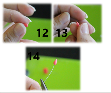

To Make Rose Buds:
Take a tiny pinch of clay and form it into a teardrop shape. Cut your 26 gauge wire as you did for the roses and stick the rose bud on top of it. Ta daa!
Set your roses and rose buds aside to dry. I made three roses and five rose buds for each earring.
