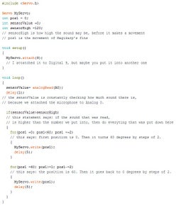

Step 6: The Code
First you go to "Sketsh" then choose "Use Libary" and search for "Servo".
That way it'll include a servo. Then you put in the code:
Servo MyServo;
int pos1 = 0;
int sensorValue =0;
int sensorHigh =120;
void setup()
MyServo.attach(9);
void loop()
sensorValue= analogRead(A0);
delay(1);
if(sensorValue>sensorHigh)
for (pos1=0; pos1<60; pos1 +=2)
MyServo.write(pos1);
delay(5);
for(pos1=60; pos1>=1; pos1 -=2)
delay(5);
