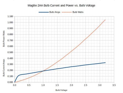

There is a lot of controversy on the actual light output of the Maglite 2AA. The bulb darkens over time, which decreases the light output. Additionally, the light output falls rapidly, while the light’s color temperature shifts to the red, as the battery drains down. Figure 1 shows the darkening of the bulb. Figure 2 shows the bulb current and power vs. the battery voltage. The opinion of several flashlight forums is that a 4 to 5 lumen specification is more realistic.

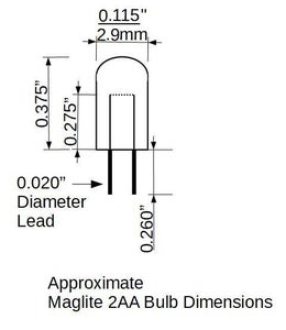

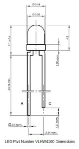

Figure 4 is a picture of the hole, in the back of the reflector, for the bulb. Its diameter is 0.128” (3.25mm), which limits the diameter of the LED to a T1 size (a 3mm diameter). After reviewing the selection of T1 white LEDs available from several distributors the Vishay part number VLHW4100 was chosen because the combination of 7150 mcd Luminous Intensity and a viewing angle of 45 degrees provided the greatest total light output of about 3.5 lumens. Figures 5 and 6 are dimensional drawings of the bulb and the LED. The LED’s maximum diameter is smaller then the diameter of hole in the reflector. No modifications of the reflector are required.

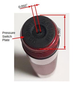

The bulb socket and switch assembly in this flashlight is 0.560 inches diameter. This determines the size of the PCB. Figure 7 is a picture of the switch plate with dimensions. The PCB will have two pins that connect to the battery power through the switch plate on the same side as the LED driver circuit, while the white LED is mounted on the opposite side of the PCB from the power pins. The PCB is assembled into the flashlight assembly between the pressure switch plate and the reflector.

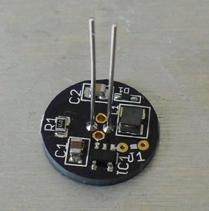

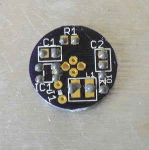

Figure 10 shows the PCB and the SMD components that will be soldered
to it. Figure 11 shows solder paste applied to the SMD pads, and Figure 12 shows the components soldered to the PCB.
The two pieces of uninsulated 24 gauge wire, 0.410” long, are made as follows: Start with a wire, 3 to 4 inches long. Grip about ½ inch on each end with pliers. Pull the pliers in opposite directions until the wire breaks. This will straighten and work hardens the wire, which will used for the leads to the flash light's pressure switch. Cut two pieces 0.410 inches long.
On the component side of the PCB, insert the wires into the two smaller diameter holes in the center on the PCB and solder in place. Figure 13 shows the wires soldered to the PCB.

Determine the polarity of the bulb contacts in the switch plate. With batteries installed measure the voltage at the bulb’s socket in the switch plate. Place a tag, or other marking, to identify the positive terminal. See Figures 15 and 16.
Remove the batteries from the body of the flashlight. Place the leads through the nylon spacer. See Figure 17. The wire lead that is adjacent to the inductor is the positive lead. Insert the wire leads from the PCB into the flashlight's pressure switch terminals. Observe the correct polarity and ensure the spacer seats in the recess of the switch plate. See Figure 18.
Install the batteries and end cap. The LED will light at this point. See Figure 19. Reassemble the focus control, reflector and lens cover and reattach to the flashlight. Do not over tighten the focus control when turning off the flashlight. The nylon spacer centers the force on the pressure switch and protects the components from contact with the switch plate

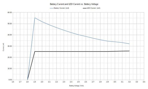

Step 5: Some Performance Measurements:
The boost regulator constant current LED driver is a constant power circuit. The power consumed by the LED and switching regulator components will be approximately constant over the batteries’ operating voltage range. Figure 20 plots the power supplied by the battery and the power used by the LED. Figure 21 plots the current drawn from the battery and the current through the LED as a function of battery voltage. The LED current is constant within a couple of mA over the batteries’ voltage range of 1.9 to 3.2 volts. The switching regulator has an under-voltage lockout circuit that shuts the regulator down when the battery voltage is at or below about 1.8 volts.
The approximate average current for this LED driver is 41mA over the batteries’ voltage range. A survey of various alkaline AA cells mAHr capacities, and their discharge curves, list capacities ranging from 2100 mAHr to 2600 mAHr. A rough estimate for the operating time of this LED circuit would be from 52 to 63 hours on one pair of batteries.
