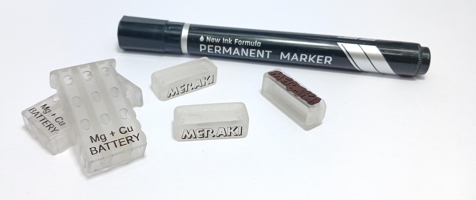

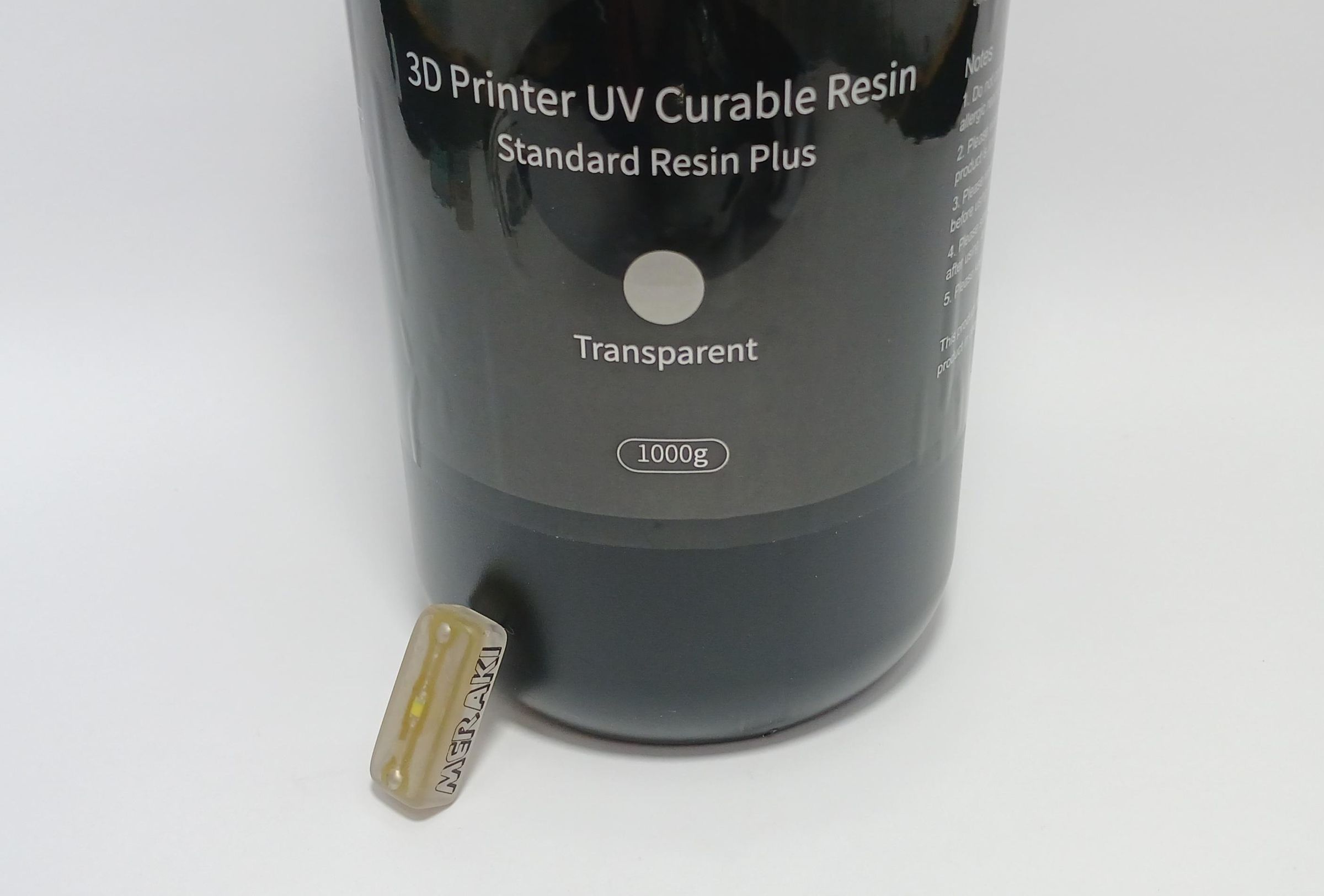

Step 2: Design and Print the Enclosures:

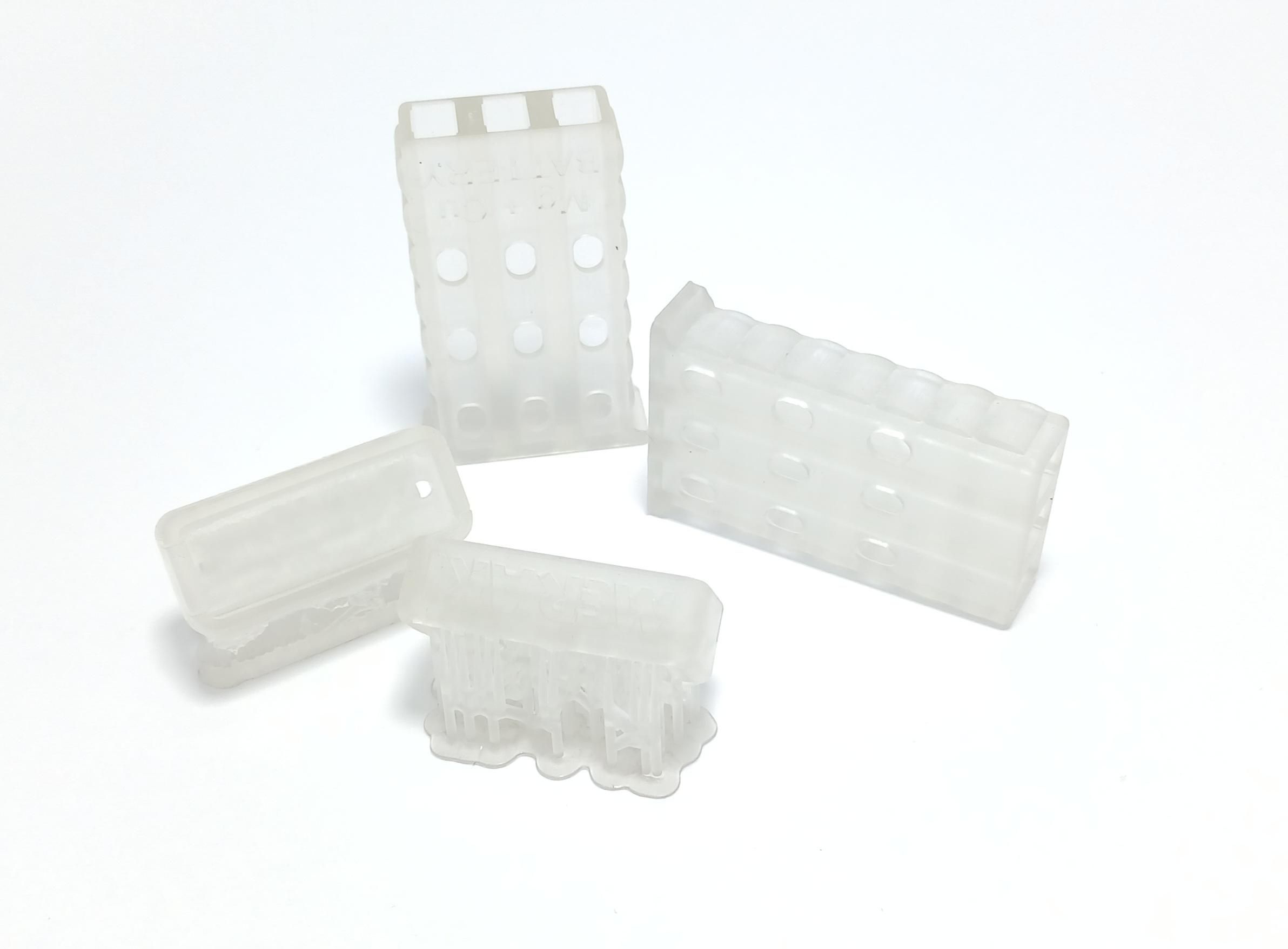

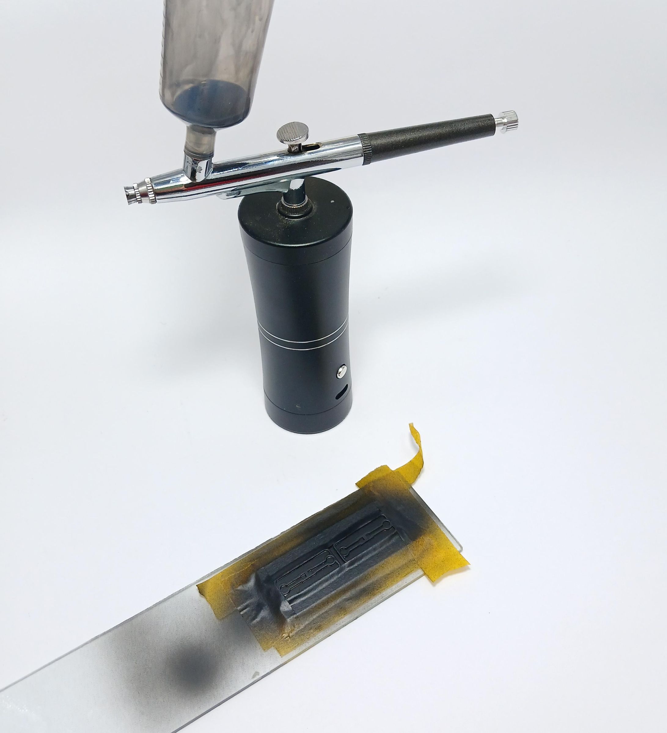

The reusable battery cases and clip on flashlight module will be 3D printed so I started by designing both of these using Fusion 360.

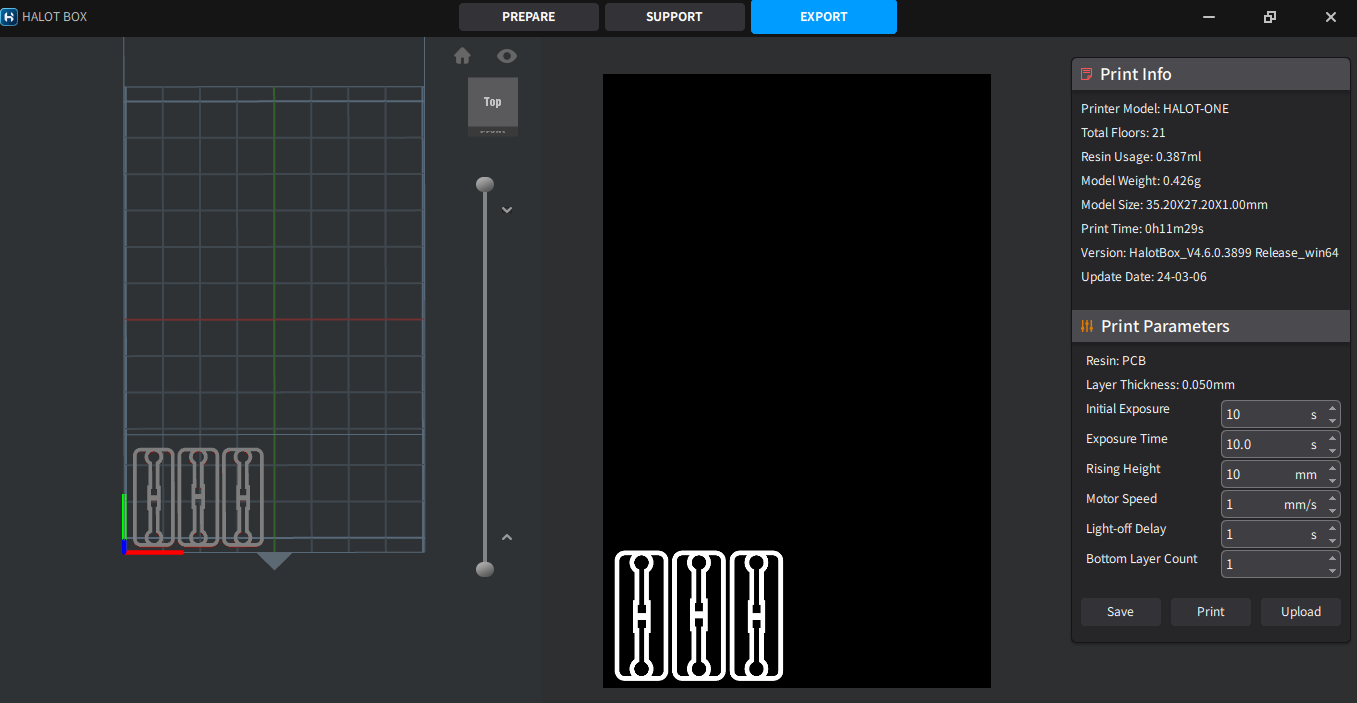

As my FDM printer is set up to print large objects with composite filament and a 0.8mm nozzle it cannot handle small prints like these so I went with my Halot One resin printer but the files should work perfectly well on a 0.4mm nozzle FDM printer.
You will only need one of each of the "Water Lamp Top.stl" and "Water Lamp Battery.stl" to build the flashlight but I recommend printing a few of the batteries to have extras ready to go in an emergency.
The "PCB Mask.stl" is only needed if you want to etch your own PCB that will be explained further in Step-4.
This is completely optional of course but after curing the print I used a permanent marker to fill the embossing for some extra style points! 🤣

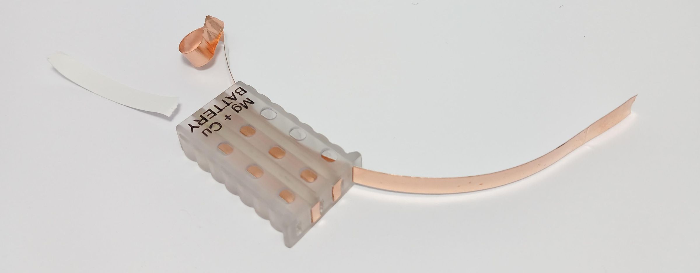

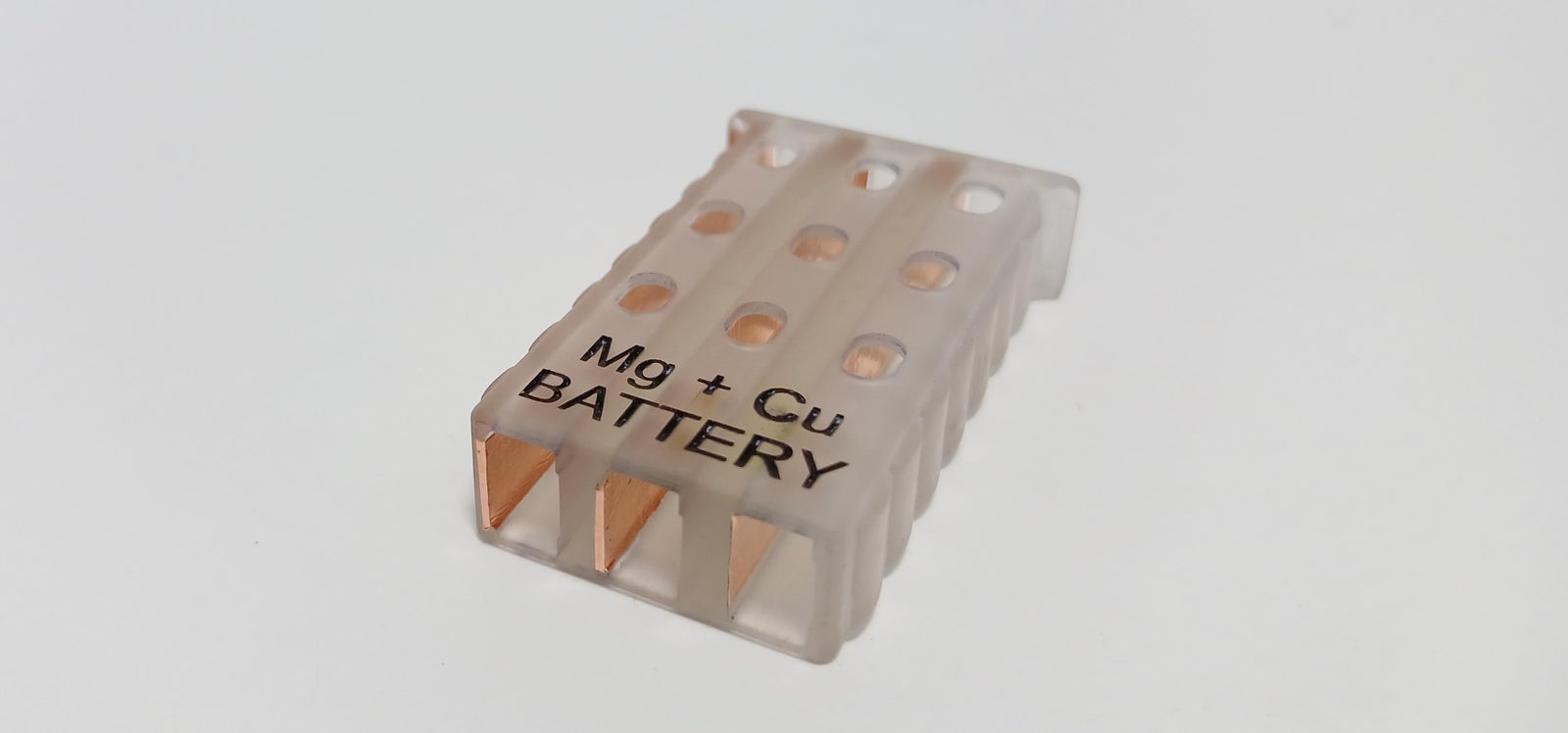

Step 3: Making the Galvanic Pile:

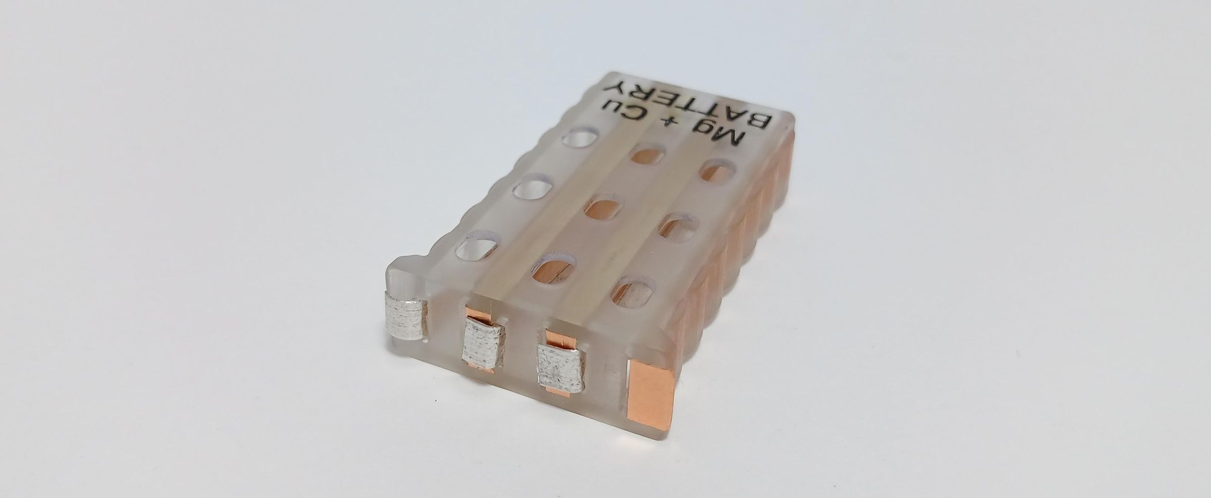

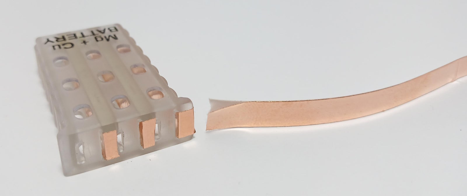

With the battery case printed we can start assembling the batteries.
I start with the cathode that will be made from self adhering 6mm copper (Cu) tape. Without removing the paper backing from the copper tape I press the tape through the 6mm slit on the top of the battery and push it through the bottom opening, I then remove a piece of the paper backing from the end of the tape that is just slightly longer battery case, I can now pull the tape back through the top and stick the tape with the exposed adhesive on the inside of the battery case.
On the top of the battery case we leave a little tab of the tape to make a connection to the neighbouring cells and light contacts.

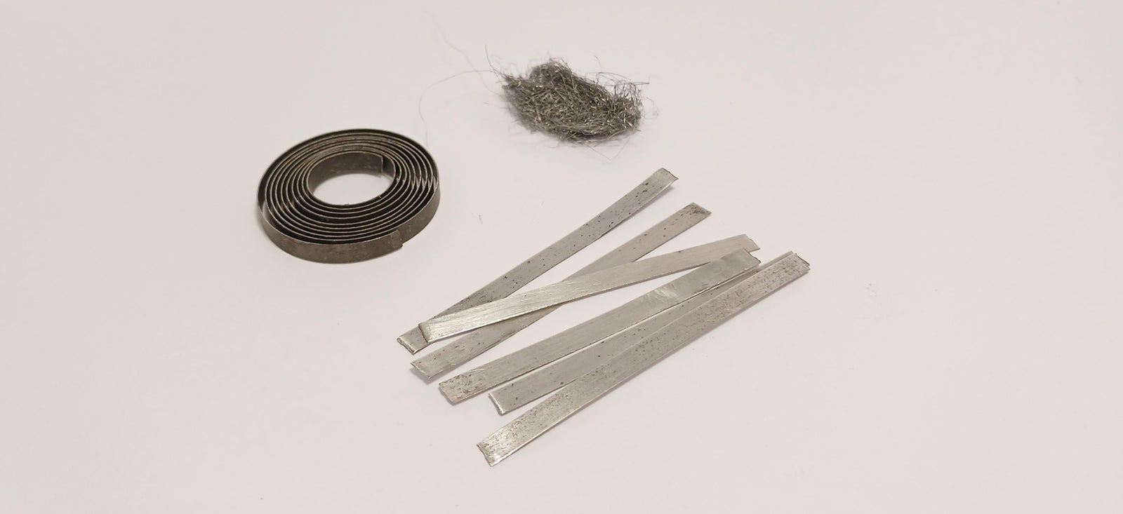

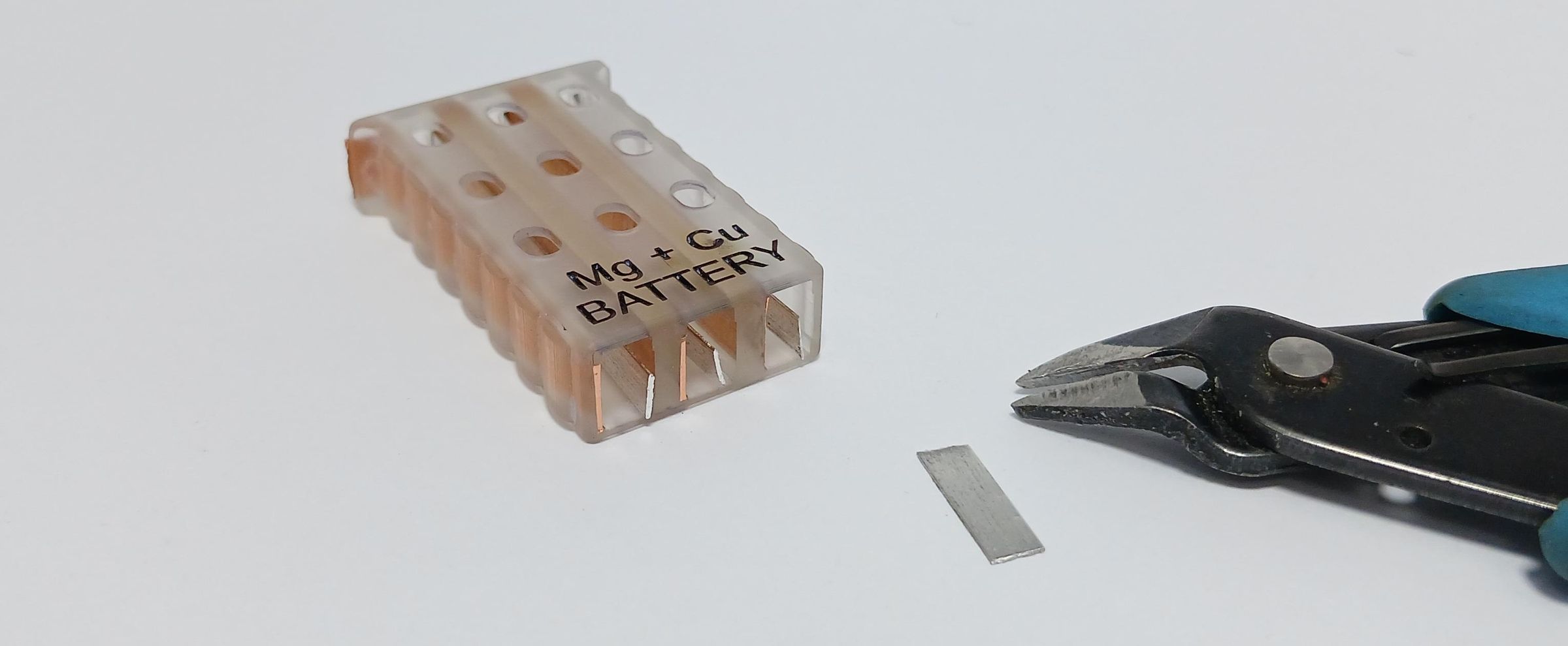

Now we move onto the anode that will be made from 4mm magnesium (Mg) ribbon.
As with aluminium, magnesium oxidizes rapidly when exposed to moisture and when you receive your roll on magnesium ribbon you will most likely notice that unlike the advertisement your magnesium will be a dark dull grey instead of bright silver. Don't worry though as this is completely normal but we will need to clean it up to get maximum efficiency of our voltaic pile, I simply use some fine steel wool to rub away the oxidation until I'm left with a bright shiny strip.
TIP: To minimize the oxidation in the future I recommend storing your roll of magnesium in a zip-lock bag with some desiccant pouches.
For each battery module I cut three pieces of the magnesium ribbon just slightly longer than the battery length, then using flat nose pliers I bend a 90 degree tab on the one end of each of the strips this will act as our connection points.
Now press each of the strips through the 4mm slit on the top of the battery so that the bent tabs sit on top of the copper tabs and cut off any excess ribbon from the bottom with some flush cutters.

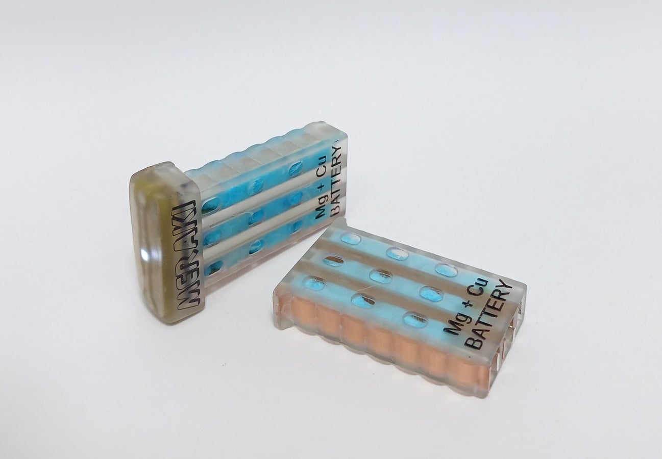

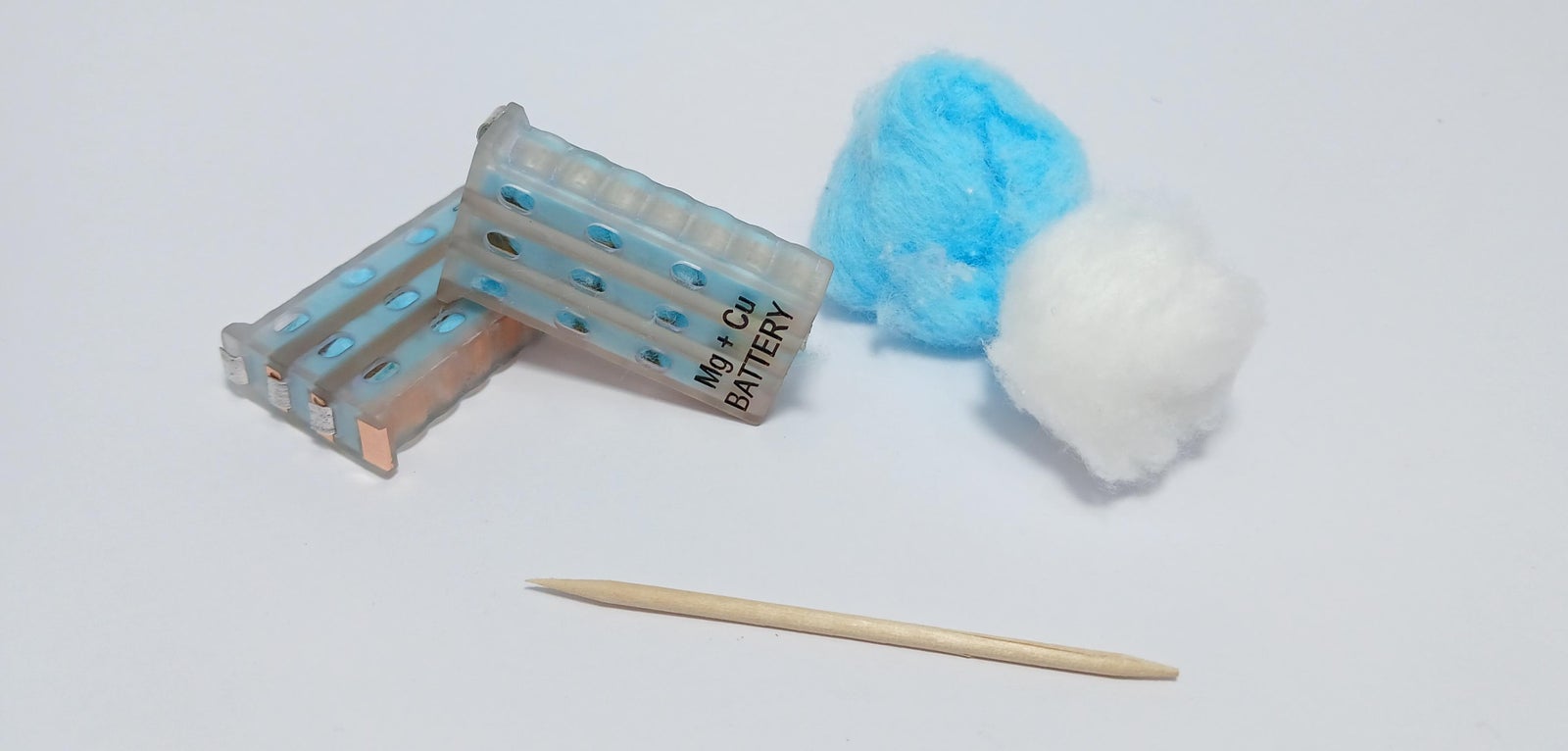

To finish the battery modules we will need to create a "salt bridge".
In this build it will simply be some cotton wool packed in between the anode and cathode that will hold onto the electrolyte.
Using a wooden toothpick I used one cotton ball per battery module divided into three pieces and then stuffed into each cavity in the battery.
You want to make sure that your hands and cotton balls are completely dry before doing this as moisture will slowly degrade your anode and cathode.

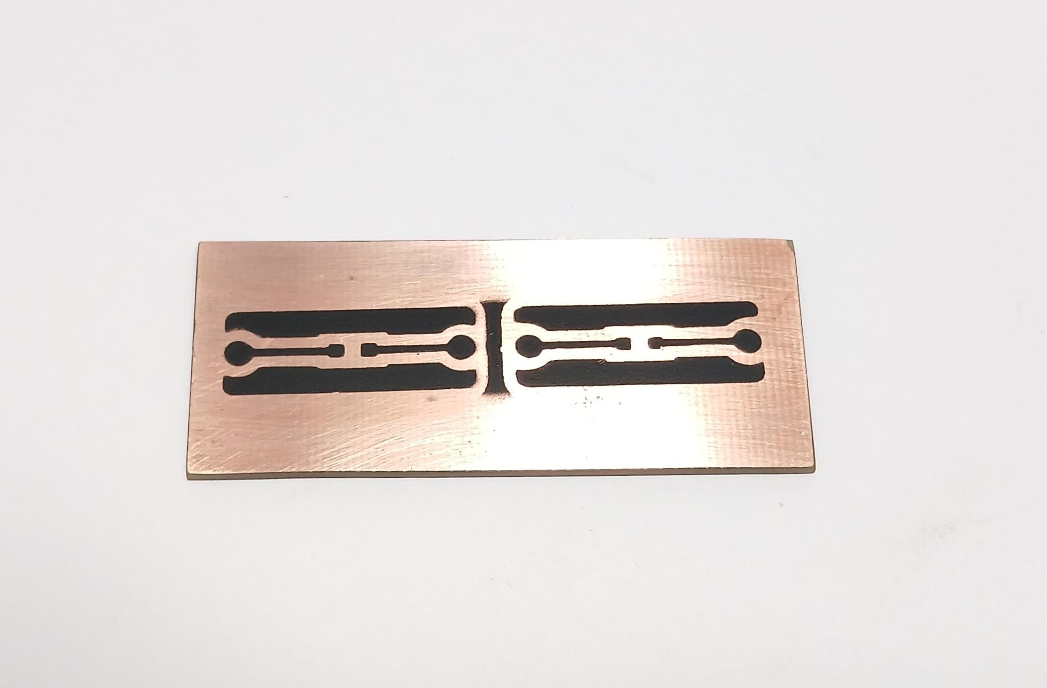

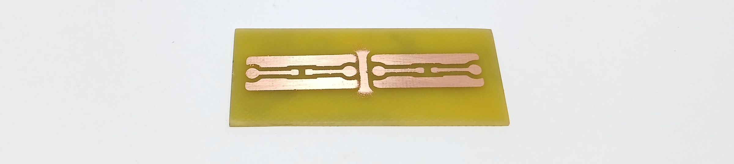

Step 4: Optional: Making the PCB
In this step I will show you how to make a PCB from scratch for the light but as this is such a simple circuit you can completely omit the PCB and pogo pins and go for a simple 5mm LED with its legs bent into pins to contact the battery module pads.
First we need an etch mask for the PCB, this is simply a barrier that prevents the copper layer from being eaten away by the etchant to make the traces for our circuit.
There are a few different methods that can be used to make the mask.
One I use often is a photoresist, this is a light sensitive film that gets adhered or sprayed onto the PCB and is then exposed to UV light to develop a negative mask on the PCB. All the areas exposed to the UV will not get etched.

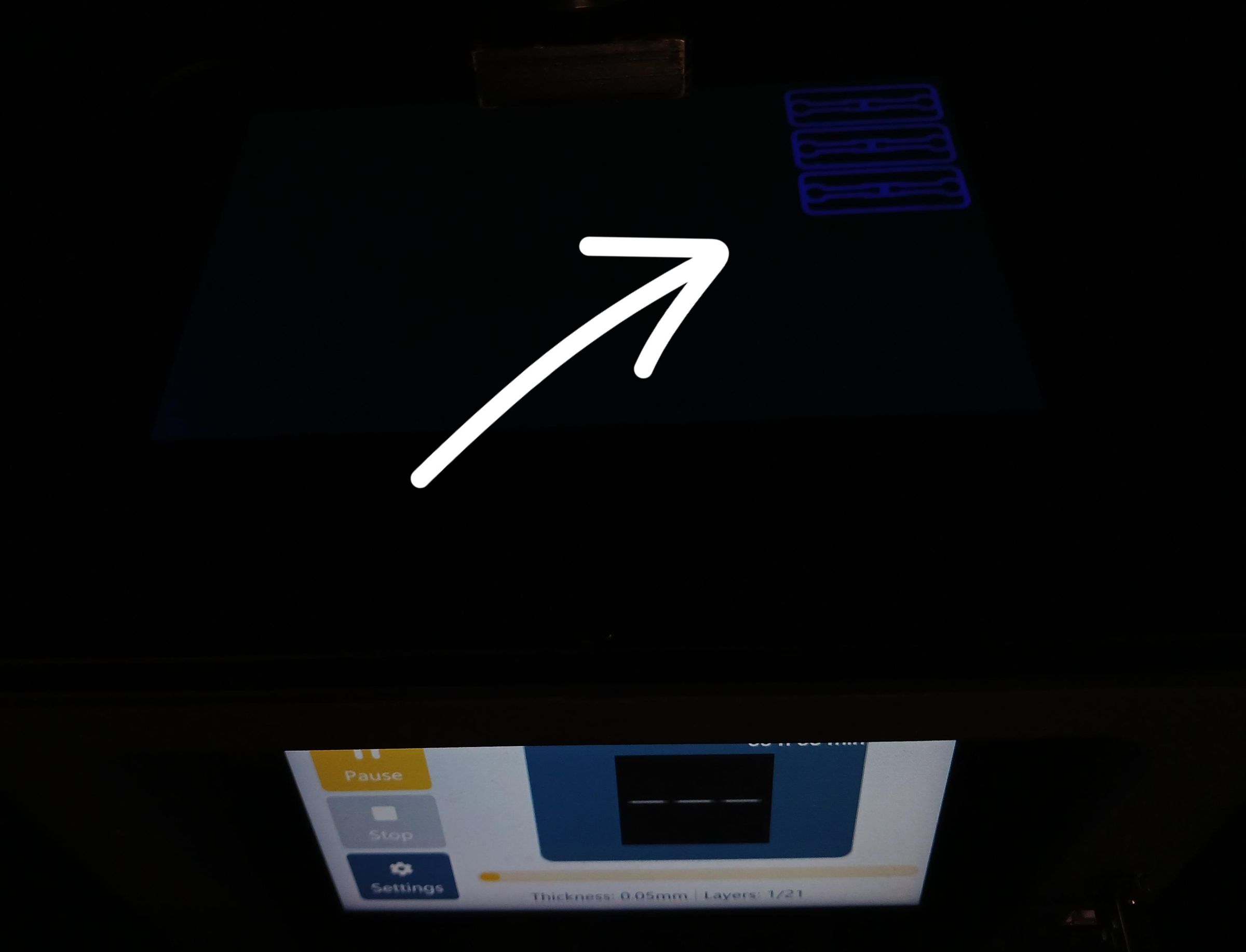

An easy way to create a photoresist is to simply use the screen of a resin 3D printer, as the process of resin printing is exactly the same as creating a photoresist.
Another method is to simply draw your PCB traces with a permanent marker or paint marker.
But as I was already printing the two components for the flashlight on the printer I decided to just print a thin template of the circuit that I can then just use my airbrush to spray onto the PCB.
With the etch mask made you now need to etch the PCB.
- WEAR ALL NECESSARY SAFETY EQUIPMENT! -
In a well ventilated room or outside mix two parts hydrogen peroxide and one part of hydrochloric acid together in a separate container. Ferric Chloride can also be used instead of this solution if you have some available. (this is your etching solution so handle with care)
Tip: The hydrogen peroxide + hydrochloric acid is a safer alternative to Ferric Chloride and is great to use when making your own PCB's
Carefully submerge the PCB into the etching solution, the copper that needs to be etched has to be completely submerged and facing upwards.
Agitate the mixture regularly.
Leave it in the solution until it has dissolved all of the exposed copper leaving behind only the copper under the resist.
When done rinse thoroughly in clean water.
You can now simply cut out and shape the boards then drill the holes needed for the pogo pins.

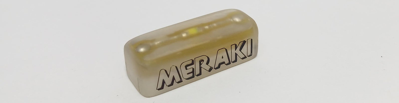

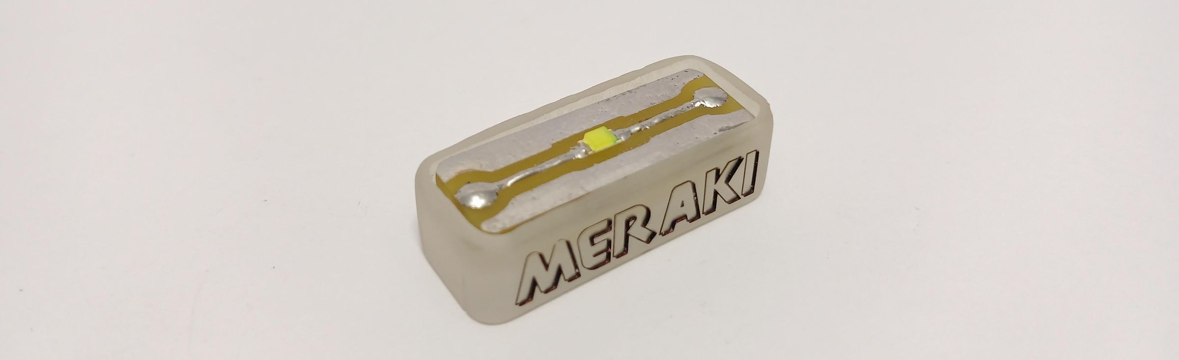

Step 5: Making the Flashlight Module:
With the PCB now made we can assemble the flashlight module next.
With the PCB made we need to solder on the three components, I start by soldering on the 1206 white LED. On the LED you will notice there is a green line on the one side, this is the negative (anode) of the diode and will go the the magnesium side of the battery module.
Next you need to solder in the two pogo pins into place so that they face to the back of the board.
In any circuit involving an LED you will always find a current limiting component in line with the diode but for the size of this cell the measured current output was between 15 and 20ma, this is perfect to ensure maximum brightness for this light and will not cause any damage.
To ensure that the PCB is waterproof I smeared some UV resin into the cavity of the PCB before pressing it into place and curing it from behind with a UV flashlight.
I used the same resin from my printer used for the parts to fill the cavity of the light in order to create a protective waterproof lens for the LED. You can also use UV curable craft resin if you FDM printed the flashlight or don't have transparent 3D resin.
With the LED section finished I cut out a piece of 1mm EVA craft foam to fit into the back of the module between the two pogo pins, this will help press the connection between the three galvanic cells together when the flashlight is clipped onto it.

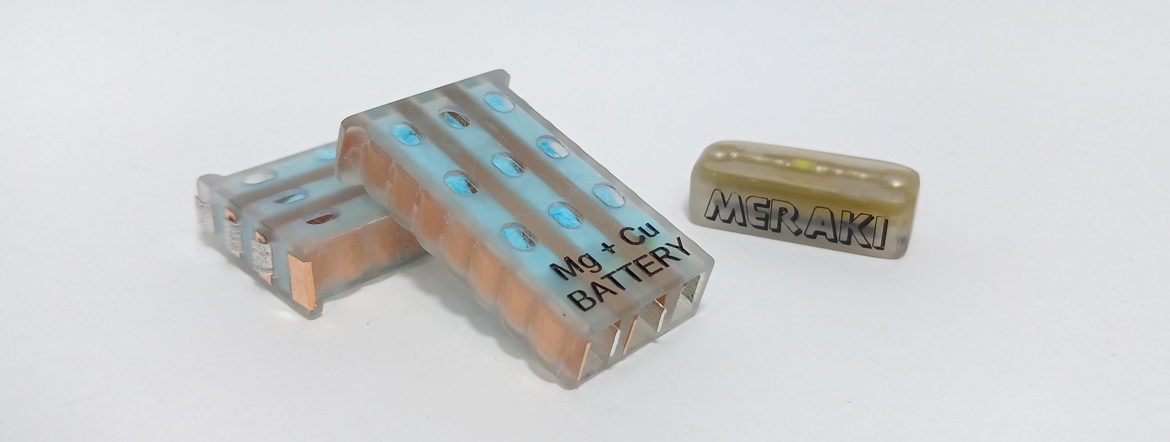

Your flashlight module is now ready for use.
Step 6: Additional Info:
- Testing of the cell with plain tap water gives a voltage of 4.5V volts and a short circuit current of around 20ma.
- For long term storage I recommend getting some heat shrink PVC packing tubes and then to seal each battery module along with a small desiccant pack, this should give you an indefinite storage life until activating.
- If you want to scale up this project you will need to add a current limiting resistor in line with your LED as the battery will produce more current and damage the diode.
Step 7: Test It Out!
The time has come to test out your flashlight, to activate it simply submerge the battery module in plain water for a few seconds so that the cotton is saturated, shake off any excess water and clip on the flashlight module.
