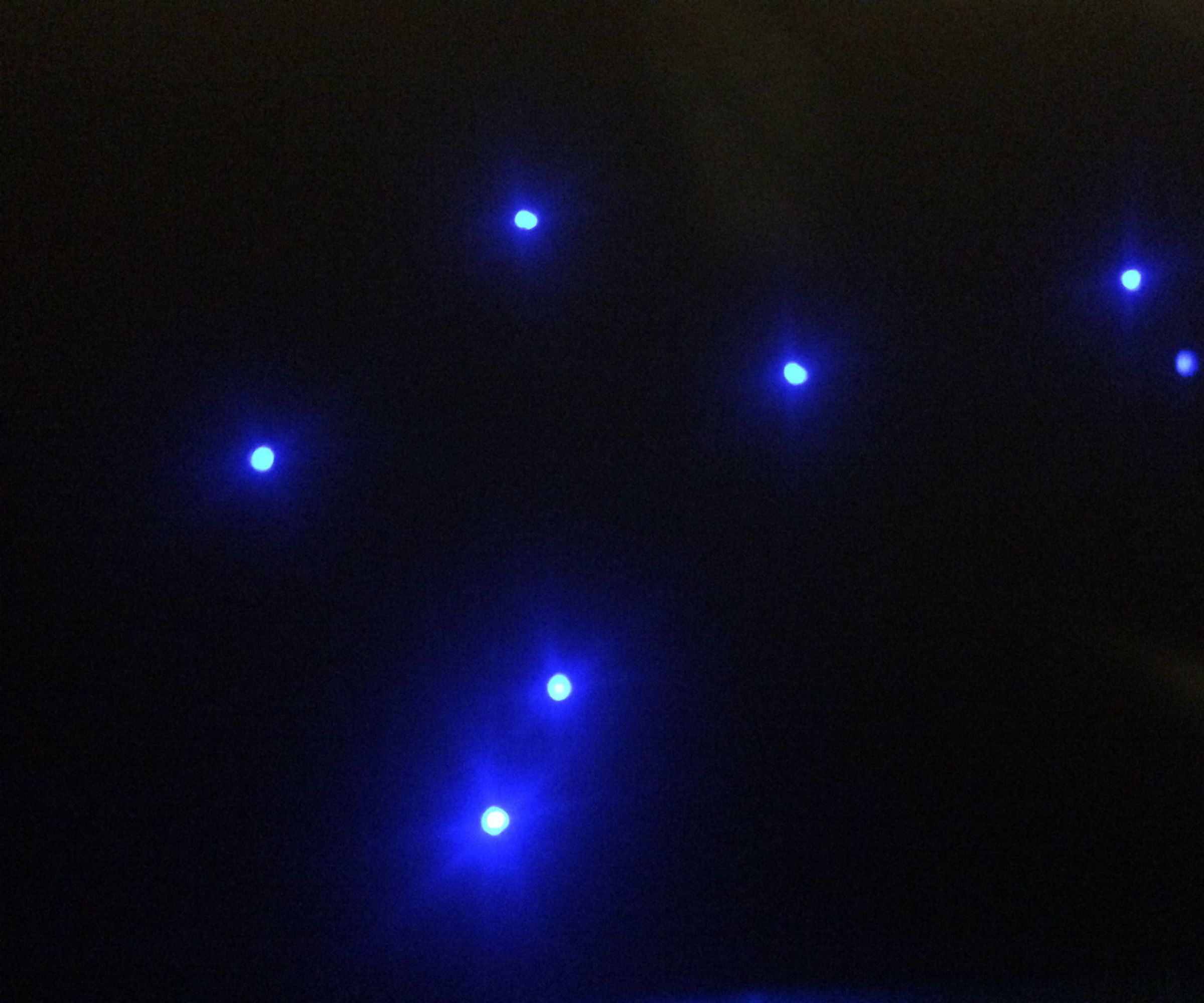

This scarf uses a simple reed switch circuit so that the scarf's eyes light up when the head is snapped to the tail. Because the switch is in the head and the magnet is in the tail, multiple critters can be snapped together in single file to make a sort of animal based light display - this could be an idea for a class project where everyone makes their own one to take home, but they trigger each other as a group project.

Put the scarf on around your neck and join the snap or velcro, see the eyes light up! If you are making this as part of a class, each critter can activate another by fastening each head onto the tail of another. Make a light up animal chain.
