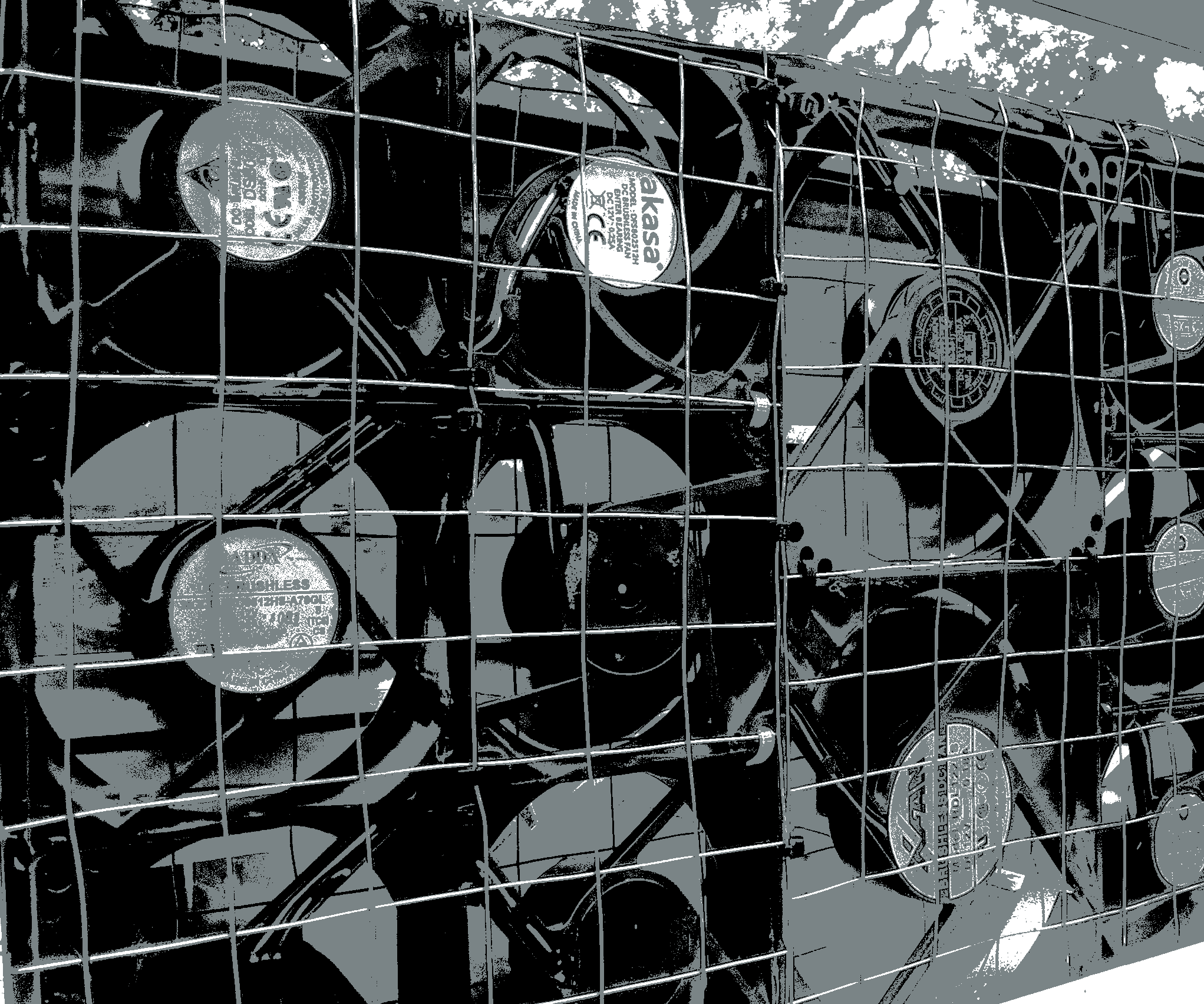

Step 2: Bolting, Glueing, Wiring in Magnets,
Bulk of the magnets are bolted to 2 large bean tin lids, using epoxy and chicken wire where needed to give some strength.
With the bolts showing on the back side of the project, able to connect the rope to the bin lid, by unsung left over children’s construction metal kit.
On the other end of the rope, 6 smaller Harddrive magnets found in smaller hard drives, wired together with a wired loop on the end.
This is perfect fishing in any storm drain for lost keys,

Step 3: Good to Go.
Works perfectly using a bag of plastic container to separate what pick up from the magnet.
